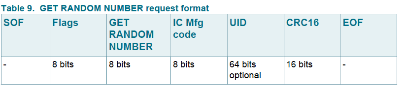

jimmychan
According to the datasheet 9.5.3.1 GET RANDOM NUMBER, the request format is:
