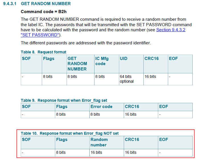

Hello everyone, I'm developing an application for Android (with Android Studio) for the
management and writing of tags ICODE SLIX SL2S2002 ISO 15693. I'm having trouble setting the
EAS / AFI password inside the tag not having understood yet what the correct sequence of
commands. I have already read the data sheets and application notes but it is not exhaustive
enough. So I would like to understand first of all if the commands I am using are correctly
formatted and obviously what the correct sequence is.

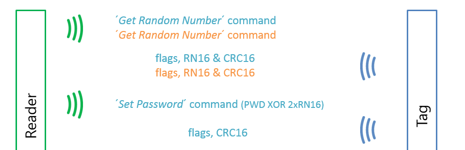

In my understanding, the correct command sequence should be as below:
Hope that helps,
Kan

marco_sanna
my "GET RANDOM NUMBER" response is like:
02 00 0A 00 B1 00 AA AA 15 7B
From this response which is the correct "random number"?
And above all to set password I should send the default password that I do not know what it is. Being the first time and the empty tag, at the "set password" I do not understand what to send.

Kan_Li
Do you have raw command sent from VCD? Addressed or un-addressed mode? Flags sent?
If we have non-addressed mode (tags in SELECted mode will response):
For example:
VCD command:
12 B2 04 1B B9
VICC response:
00 8A 4C 18 3F
On SLIX there is only EAS/AFI password: 00 00 00 00 – if the IC is coming from NXP fab. Maybe label manufacturer re-set this pwd.
Hope that helps,
Kan
