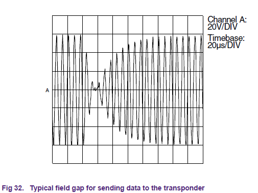

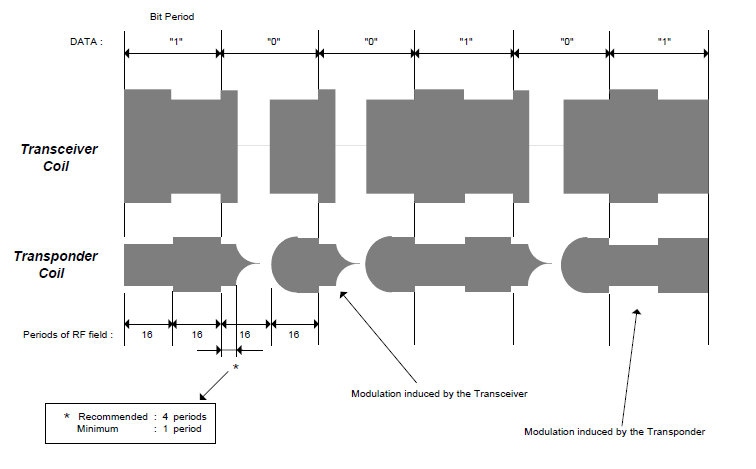

I want to write data to transponder. How can i manage output? I  read, successfully. But, i can't see any change in the write mode. Fig 32 is HTRC110 Modulation principle. The picture on the right is the writing protocol I want to make. On-off switching . How can i do this.
