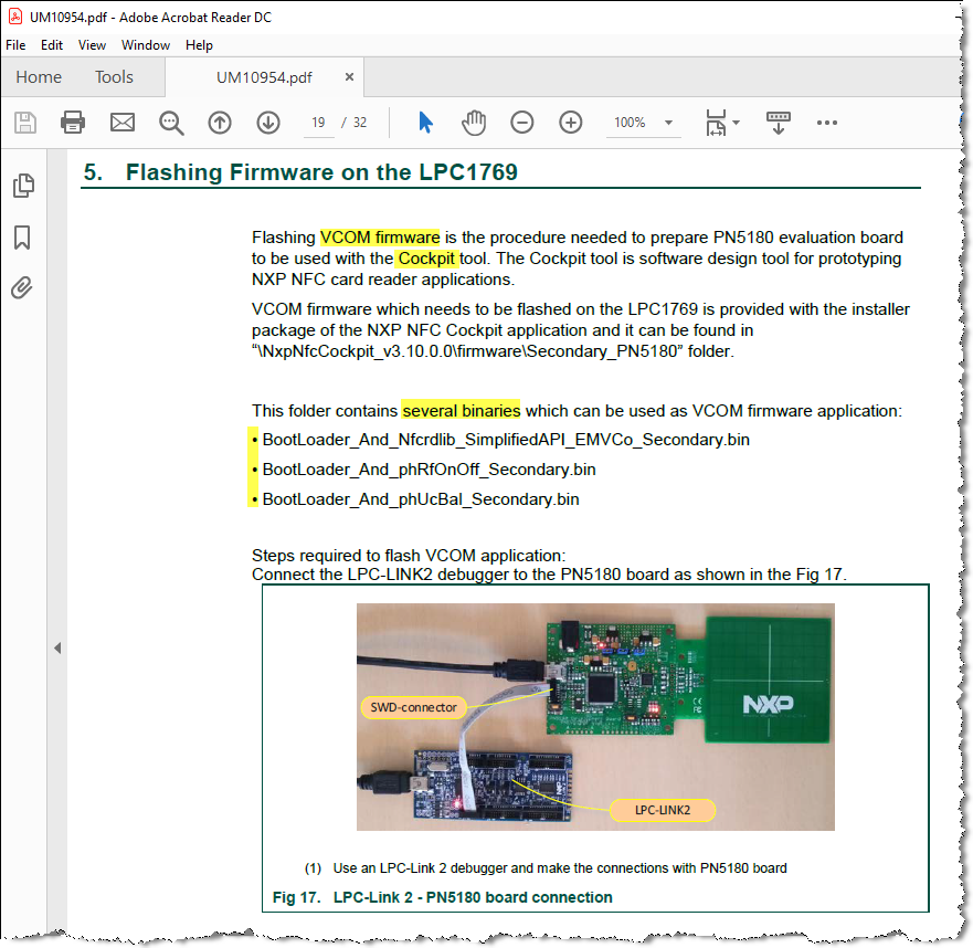

Hi Stefko Urumov,
You can find these binaries in “\NxpNfcCockpit_v4.8.0.0\firmware\Secondary_PN5180” folder.
Robin
