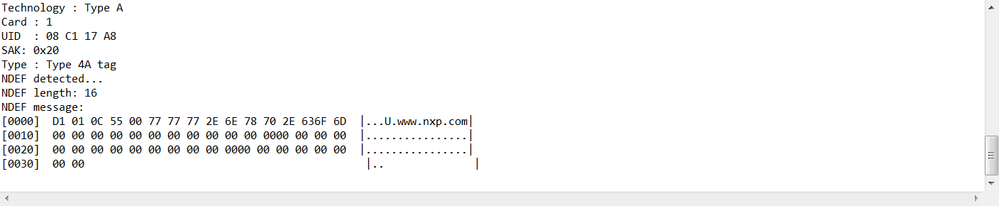

      I am trying to run NfcrdlibEx8_HCE_T4T example to emulate NFC Forum Type 4 Tag. Till now I am able to write and read NDEF Message from other reader (also PN7462), but the problem I am facing is that I also want to read message inside my card emulation reader and print to console, but  I don't understand how can I do that. I assume that DEBUG_PRINTF(); function should be in Application thread after AppProccessCmd(); Before calling that in AppProcessCmdCallback() I update the file :
uint8_t Data[16];  // create variable for saving the data from file.(this variable global)
(void)memcpy(Data, pRxData, wRxDataLen);
(void)memcpy(&pSelectedFile[dwFileOffset], pRxData, wRxDataLen);
where I understand that NDEF meesage received from other reader is in pRxData so with memcpy function I copy that message to Data variable and later on trying to print it but I get empty message.
Other question would be is it possible to send message back from card emulation reader to other device (reader)? Because after all I want to achieve bi-directional communication between two readers.
Thank you

I flashed one reader with NFC Forum example and the second one with HCE_T4T, now I am able to see the NDEF message (‘www.nxp.com’) of the example on the console of the reader flashed with NFC Forum example.
It is being detected as a Type 4A Tag (as it should). Please take a look at those examples and the way they work, in the HCE side where the message is set and in the NFC Forum reader, where the NDEF message is being stored and printed in the console. If you want to work with a bi-directional communication, they should work in peer-to-peer mode also possible in NFC Forum example.
Ivan.
