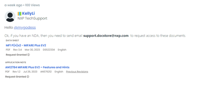

Hello @mygodess
Ok, if you have an NDA, then you need to send email [email protected]  to request access to these documents.

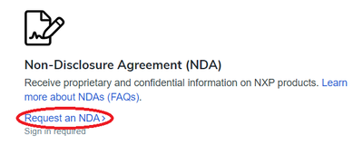

KaiLi
Hello @mygodess
Yes, RFID Discover can do what you want, but it's not suitable for mass production. However, the design resource you want are the security documents, and you need to sign an NDA with NXP to have access.
so please establish an NDA with NXP by going to  https://www.nxp.com/support/support:SUPPORTHOME and select "Request an NDA"

3,804 Views
KaiLi
Hello @mygodess
Have you got the two documents mentioned above?
