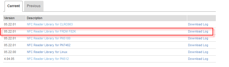

Kan_Li
Did you download the latest NFC reader library for FRDM-K82F?
and are you referring to https://www.nxp.com/docs/en/application-note/AN11908.pdf ?
Were CLEV6630B and FRDM-K82F used on your side?
Please kindly clarify.
Thanks for your patience!
