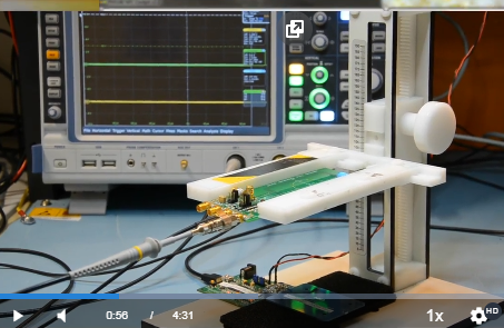

Good evening,
           There is a pdf in which it is written what settings affect what, recommendations on how to properly calibrate with training videos and useful materials, otherwise it is difficult to immediately understand how and what to do from one video?
            My task is to correctly calibrate the PN5180 in terms of power and tune the antenna to the maximum sensitivity and reading distance.
Assume that we do not work at NXP and we are trying to study your wonderful product for at least some crumbs of knowledge.
Alexey.

One can refer to the documents for the question.
URL:https://www.nxp.com.cn/docs/en/application-note/AN11744.pdf.
https://www.nxp.com.cn/docs/en/application-note/AN11740.pdf.
Hope it help you. Have a nice day.

Thank you very much for your reply. I understood what and where to do. The question is, where can I get the test antenna that is used in the video during calibration? Where to buy this ?
