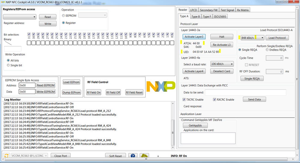

I am using the CLRC663 chip coding with 14443A protocols. For the configuration of the used protocol and coding speed I refered to the application note AN11022.
106 kBit/s and 212 kBit/s seems to work fine so far, but I got timeouts while using 424 kBit/s and 848 kBit/s.
Are there any known issues using these higher baudrates along with the CLRC663?
Or is there maybe a new application note regarding this issue?

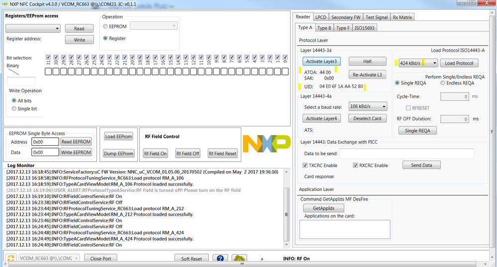

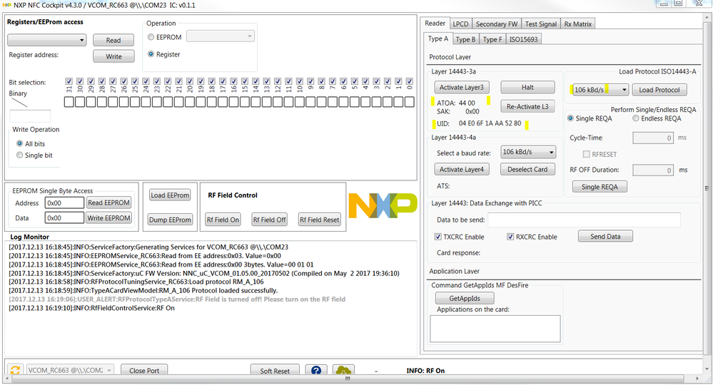

If you are working with a custom board that would be the cause. I just tested it with our evaluation board CLEV6630B. As you can see in the following images, I loaded the 4 different protocols and then activated the card, As you can see I am able to read the card UID without any problem.
106Bd/s:
212 kBd/s:
424 kBd/s:
848 kBd/s:
I recommend that you start with our evaluation board and then move to your custom hardware. Or refer to our antenna design guide in the documentation section of CLRC663:

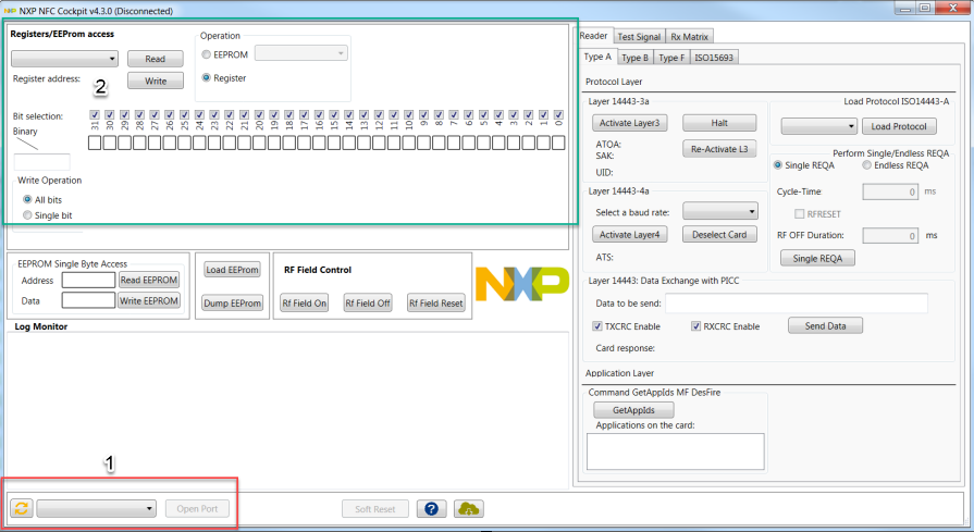

Activating the card isn't my problem either. I just run into timeouts when trying to send APDUs.
Do you know whether this test tool of yours JUST uses the "Load Protocol" command or is it maybe using some additional regsiter settings?
Best Regards, Tom

Hi Tom,
Sure, once you connect to the board (1), you will be able to read from or write to the Registers in number 2 section.
Please download NFC Cockpit from the following link in the DOWNLOADS section. you will also find documents in the DOCUMENTATION section for this software:
NFC Cockpit|NXP
I hope this is of great help!
