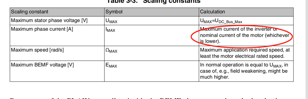

when I used the module of the function AMCLIB_BemfObsrvDQ, I have some question about parameter settings
 is the Imax equal to the Iscale, and the Umax is also,
if the Imax is not  equal to the Iscale ,the parameters is wrong,beacuse  the normalization uses Iscal,
so ,Ineed your help ,thanks

the scaling of all physical quantities must be consistent throughout your processing chain to ensure correct results. Use the same maximum current to scale all parameters of all functions in your control loop. The same rule also applies to the maximum voltage and the maximum angular velocity.

Could you, please, elaborate on what do you mean by "Imax equal to the Iscale" "the normalization uses Iscal", share some equations/ screenshots?

The MCU is MC9S12ZVM, and the document is MC9S12ZVMMCLUG
The parameter calculation in the document use Imax ,I want to make sure that if the Imax equals the Iscale?
