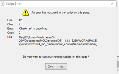

I am using MIMX1024-EVK with FRDM-MC-LVPMSM board. I am trying to run the PMSM demo project. Communication between the PC and EVK is working but when I drag and drop the .pmp file from the MCUxpersso IDE v11.4.1 to Freemaster 3.1 I am receiving the below error message. Could you please help me with this error?
Thank you in advance.
When I select Yes, below error message showing:

Hi Krish403,
This error message is caused by an MCAT (motor control html+js script running in FreeMASTER). We are trying but can't reproduce your issue, trying various clicking in MCAT. Could you please describe the sequence how to reproduce the issue? Which buttons do you click in MCAT or does the message appear right after starting the FreeMASTER communication (gree GO button)?
Thank you for more information,
Josef

Hi, thank you for the response. Somehow, I have resolved from the previous mentioned error. But now I am receiving new errors. I am following the below process to run the demo mc_pmsm SDK project.

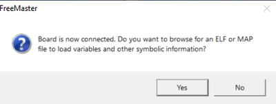

I have followed the process as you mentioned (GO button). After that window popped up.
Here I have selected symbol file from the evkmimxrt1024_mc_pmsm_1 > Debug > evkmimxrt1024_mc_pmsm_1.axf.
File format: Binary ELF with DWARF2/DWARF4 dbg format.  Please correct me if I am wrong.
After this I am dragging the .pmp file to freemaster. Here is the fault number: 4
Fault is not disappeared when I press CLEAR FAULT.
Please let me know your comments.

joseftkadlec
Hi Krish,
Comments to your previous issues:
  • DCbus overvoltage fault: I assume you have solved since you can spin in Scalar.
  • FreeMASTER map/elf/axf files: The example features TSA (Target Side Addressing) table so no map file is required and you should see variables' values even with blank Options -> MAP Files -> Default symbol file field. I can't reproduce such issue. Don't drag/drop *.pmp file. Just double-click it in the extracted_package/middleware/motor_control/freemaster/pmsm_float_enc.
