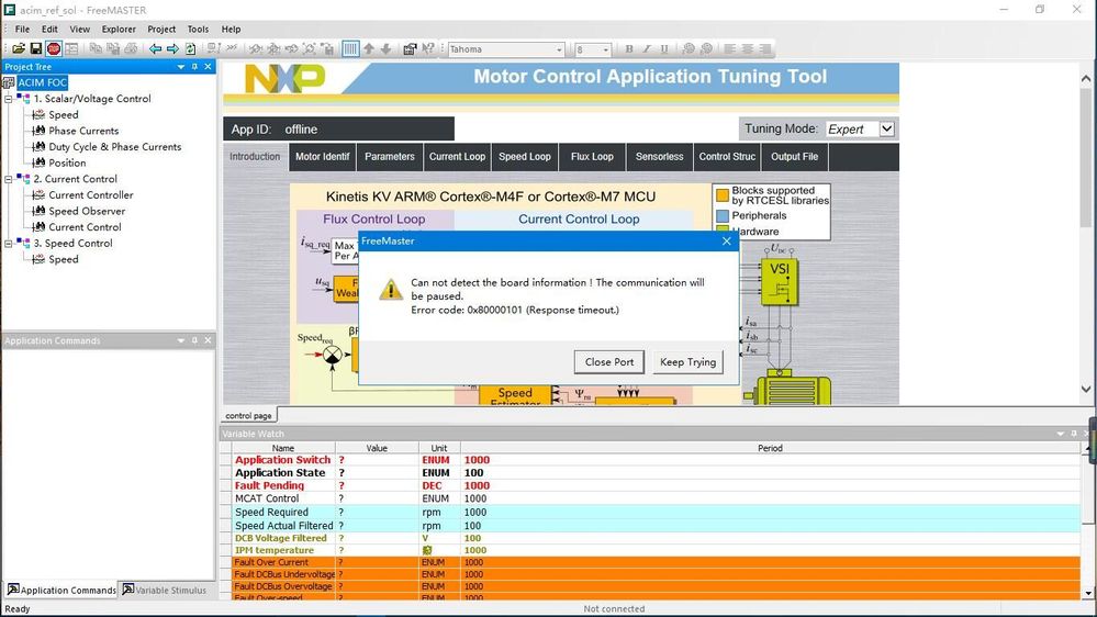

This problem occured when we tapped the "start" button,trying to power the board to control the AC motor.
2,168 Views
wesson_ding
Notice that the uart communication port for this project is from  OpenSDA (not from RS232 on HVP)
And UART Baud rate is 56000.
2,168 Views
richy_ye
This seems the communication isn't connected. Can you show your communication settings details for check? Thanks!
