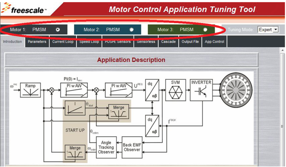

Hi All,
I'm using an example project from "MCRSP_PMSM_V1.2.0" and also FreeMaster+MCAT "pmsm_ref_sol.pmp". For my application I need to handle parameters for two PMSM motors in one FreeMaster+MCAT project. According to the datasheets it is possible, but in "pmsm_ref_sol.pmp", the motor selector bar is missing.

Hi Filipe,
Thank you very much for the information provided. Your answer is not exactly related to my question about 2 motors in one FreeMaster + MCAT project (see the picture below), but it still gives me very valuable guidance in my work.
