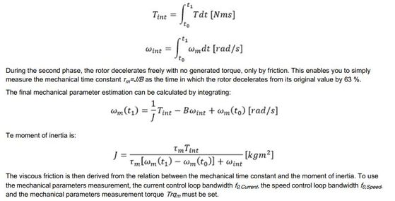

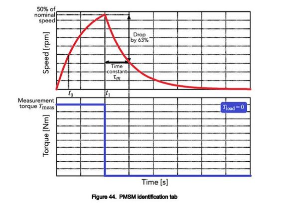

In the Document "MCUXpresso SDK 3-Phase PMSM Control(KV)  Document Identifier: 3PPMSMCKVug", Chapter 11 introduces the measurement of mechanical parameters. In the calculation of moment of inertia, it is necessary to know the value of electromagnetic torque. May I ask how to measure the electromagnetic torque Trqm?

Many motor parameters do not have the moment of inertia, need to be measured.I would like to ask, according to the measurement method in the document, the electromagnetic torque is required, how should the electromagnetic torque be measured?
