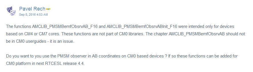

Hi I'm using my own board of MKV10Z32VLC7(CM0 based device). Unfortunately the AMCLIB_PMSMBemfObsrvAB_F16 is not available for CM0 based devices. It's based on FOC control of PMSM motor.165326_165326.jpgpastedImage_3.jpg
We are processing with the same processor because of low cost. Now we want to calculate the back-emf sin and cos components to find omega(rotor position) and theta(speed) using AMCLIB_AngleTrackObsrv_F16 function. Is there any methods or formulas to find the back-emf sin and cos components through c-programming.

Hi, of course as each function the sine and cosine components of BEMF can by calculated manually. In general it works according following equations:
f32TmpEObsrvAlpha= psCtrl_sCtrl_f32IAlpha_1 + (psCtrl_sCtrl_a32IGain + psCtrl_sCtrl_a32PGain) * (psUAlBe_f16Alpha - psCtrl_sIObsrv_f32Alpha)
f32TmpEObsrvBeta = psCtrl_sCtrl_f32IBeta_1 +  (psCtrl_sCtrl_a32IGain + psCtrl_sCtrl_a32PGain) * (psUAlBe_f16Beta  - psCtrl_sIObsrv_f32Beta)
f32TmpEObsrvAlpha= f32TmpEObsrvAlpha / sqrt(f32TmpEObsrvAlpha ^ 2 + f32TmpEObsrvAlpha ^ 2)
f32TmpEObsrvBeta = f32TmpEObsrvBeta  / sqrt(f32TmpEObsrvBeta ^ 2  + f32TmpEObsrvBeta ^ 2)
f32TmpIObsrvAlpha= a32IGain * psCtrl_sIObsrv_f32Alpha + a32UGain * psUAlBe_f16Alpha + psIAlBe_f16Beta  * f16Speed * a32WIGain + a32EGain * f32TmpEObsrvAlpha
f32TmpIObsrvBeta = a32IGain * psCtrl_sIObsrv_f32Beta  +  a32UGain * psUAlBe_f16Beta - psIAlBe_f16Alpha * f16Speed * a32WIGain + a32EGain * f32TmpEObsrvBeta
Sin = -f32TmpEObsrvAlpha ...   for  f16Speed < 0
Sin =  f32TmpEObsrvAlpha ...   for  f16Speed >= 0
Cos= -f32TmpEObsrvBeta  ...   for  f16Speed <= 0
Cos= f32TmpEObsrvBeta    ...   for  f16Speed > 0
The results of some operation must be saturated or correctly shifted to obtain the right value range and in real there are some tricks to calculate the results with determined precision.

The terms psCtrl_sCtrl_f32IAlpha_1, psCtrl_sCtrl_a32IGain, psCtrl_sCtrl_a32PGain etc., are available only in AMCLIB_PMSMBemfObsrvAB_F16 library file. Here in MKV10Z32VLC7 the files are missing so I can't able to find out these values.
There is no backemf observer available for ALPHA and BETA terms, available only for D and Q terms.
Here we are porting the code from MC56F82726 to MKV10Z32VLC7. AMCLIB_PMSMBemfObsrvAB_F16 is available in MC56F82726 but not in KV10.
