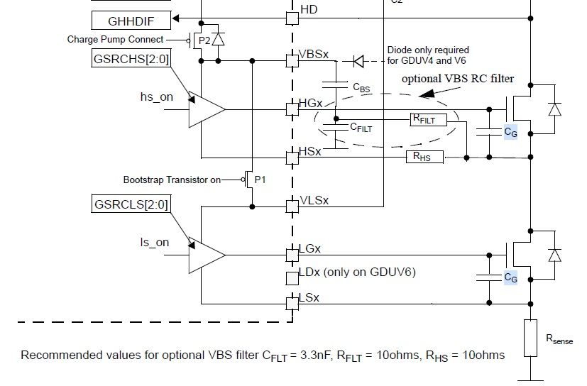

Hi Dear,
        I used ZVML31 to control DC Motor. The GDU can't output signal. If the "Rsense" in figure is changed from 10 MilliOhm to 200 Ohm, The signal of GDU is well. Please help me analyze this problem.
