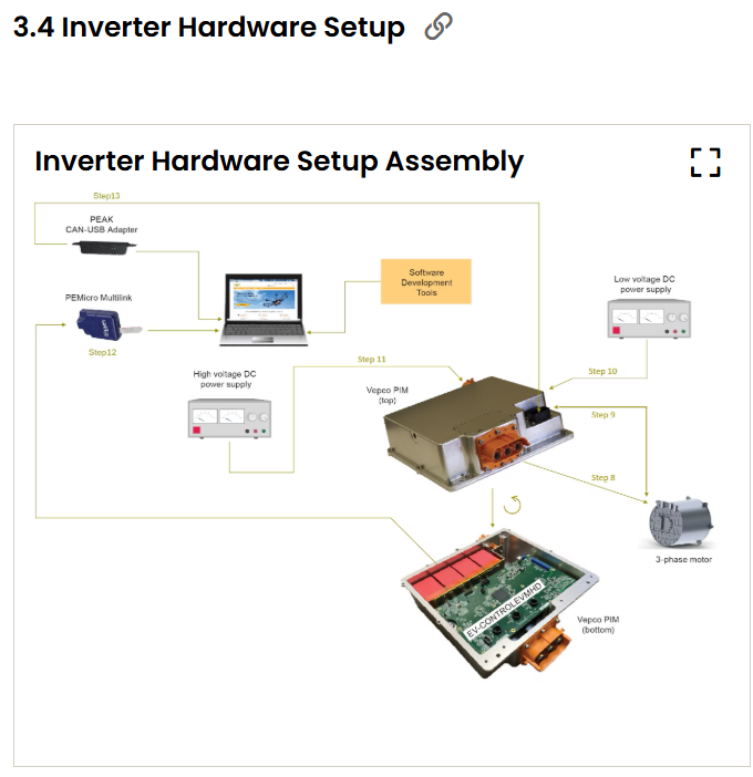

Hello Ragul,
unfortunately this will not work. Please check: https://www.nxp.com/docs/en/user-manual/UM12210.pdf
And this link.
Q1 — Minimum DC‑bus voltage?
[A] No published value. The inverter is designed for 400–800 V, and no low‑voltage mode is documented.
Q2 — Can it operate at 24–48 V?
[A] No. At ~29 V it enters FAULT and cannot reach RUN.
Q3 — Are modifications required (UVLO, pre‑charge, DC‑bus UVP)?
[A] NXP does not provides any official support or method to modify these safety mechanisms.
Q4 — Current sensing recalibration?
[A] Would be required, but irrelevant because low‑voltage traction operation is unsupported.
