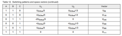

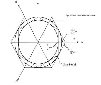

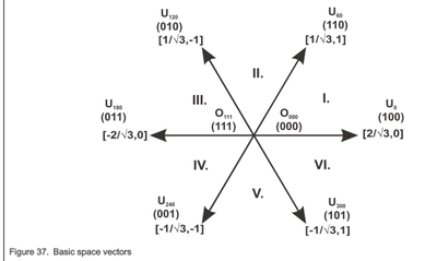

I was referring to one of the NXP user guide
when plotted for example for 100 configuration the 2/3VDC has become 2/Sqrt(3). I understand from other document
the 1/sqrt(3) part. But how 2/sqrt(3) has come? Is it related to 3rd harmonic injection? Please help.
