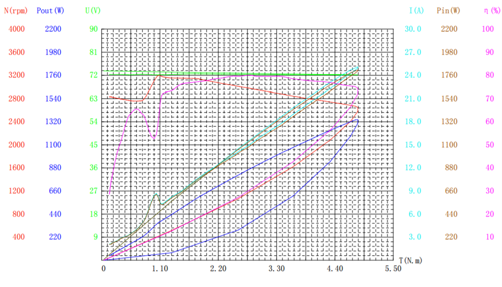

Thanks very much Philip!  In the meantime, I received a correction on the motor specs:
The motor is 72V, not 82V
1.2kW, 3 phase Brushless DC
Hall effect sensor included (running at +6V)
Also, please correct me if I'm wrong.  I should suggest that my customer purchase the HVP-MC3PH along with the HVP-KV31F daughter card to drive the motor?
At first glance, 120V seems a bit too high for a 82V max (72V nominal) motor.  Could this potentially cause arcing at the motor and possibly damage the stator?
Is there anyway to control voltage, or look at models with lower voltage thresholds?
Here is some info on the motor's power/torque characteristics:
Thanks again!
Paul

pavelsustek
Hello Paul,
the proposed HVP-MC3PH board will work fine with even lower supply voltage than 72VDC (60VDC can be considered as lowest limit). However, the customer will have an issue to achieve maximum required current (24Amp from diagram above). The original board scale is 8Amps. It migh be increased to e.g. 10-12Amps by few component replacement but I guess it won't be still enough to meet cstm requirements.
Anyway the HVP-MC3PH board might be used for inital testing to a limited output power.
Pavel

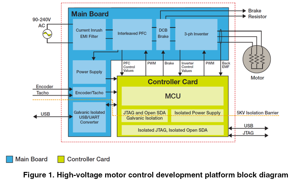

philip_drake
Hello Paul,
Yes, NXP does has a development platform to drive his motor directly.  High-Voltage Development Platform,
It comes with a HVP-KV46 daughter card, but also available is the HVP-KV31F daughter card.  The HVP-KV31F daughter card has the Kinetis Motor Suite library pre-programmed into them allowing non-motor control experts the ability to turn and spin motors quickly.
The HVP platform is able to drive up to a 1KW motor from 120-220 V mains.
I hope this helps.
