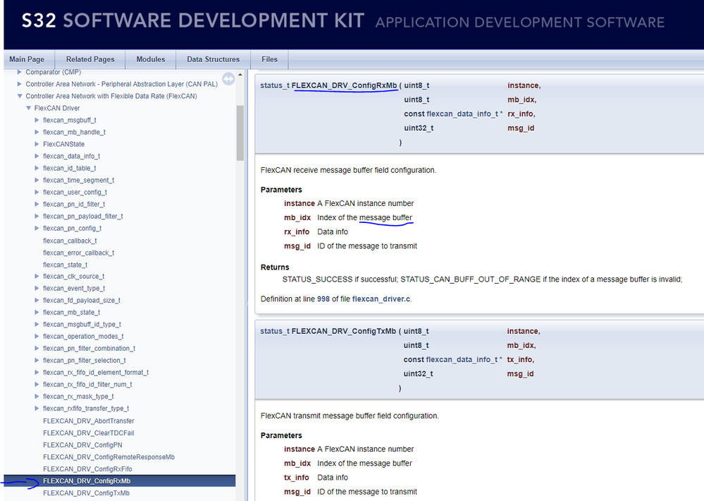

constantinrazva
Hello [email protected]‌,
The SDK comes with documentation - accessible from {SDK_ROOT_DIR}\doc\Start_here.html. Here you can go to Modules -> Controller Area Network with Flexible Data Rate (FlexCAN) -> FlexCAN Driver (navigate from the list on the left). You can find all DRV functions and some details & info.
This is an example for the function that you are asking - when in doubt, you can double check with the documentation.
The Mb refers to message buffer. The same goes for the FLEXCAN_DRV_Receive function - 2nd parameter, mb_idx, refers to the index of the message buffer.
