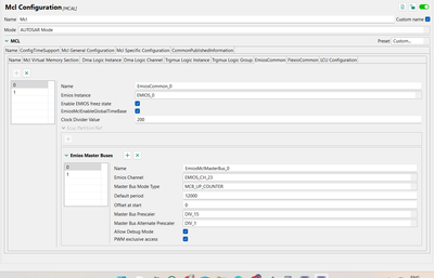

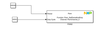

Currently, I am working with a PWM Simulink model. The issue that I am facing is that when I set the period and duty cycle values in the Simulink environment(first image), those changes do not get reflected in the processor(S32k312-Q172) after the build process. The changes that I make in the tool's configuration (as in the second image) are the ones that change in the processor. Please clarify! is there any steps required to overwrite the default values set in the tools configuration, please clarify!

In addition to the previous query can you also check if something is wrong with my default s32k312 .mex file
