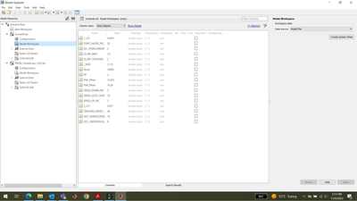

stefanvlad
Hi Sriram,
I have looked into your attached model, but it seems there are no modification from the standard model and also it is an older version of the model. We have made some updates for it. I do recommend downloading the latest 4.3.0 Toolbox from: NXP Model-Based Design Toolbox for S32K1xx MCUs - ... - NXP Community
Also, what kind of motor are you using? and what hardware for invertor and all details
Since the model we provide is designed to work on the Kit we deliver: S32K144 BLDC/PMSM Development Kit | NXP Semiconductors. It has 12V power supply and not 150V. This is a problem since you will need to rescale a lot of variables for the control system to work with this High Voltage.
First download latest Model-Based Design Toolbox for S32K1xx – version 4.3.0
Then you will need to modify parameters from Model Explorer:
You will need to modify all those parameters for a motor running 150V with 100A.

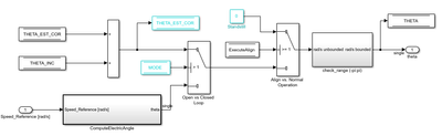

stefanvlad
Hi Sriram,
Have you looked into the article Module 8: Speed Control - NXP Community check Fig. 31: Rotor Position Conditioning?
It is normal for the motor to draw a large current during the alignment phase, as this will block the motor shaft with that high current, making a standstill of the rotor.
Then the motor control code will start open loop phase, and have a start-up ramp, increasing the speed until it reaches 400 RPM and then it will go to closed loop, using the Hall sensors to read the motor speed and correct the speed loop.
This should help a bit more,
Look in PMSM_ClosedLoop_s32k144/S32K144 EVB/SlowLoopControl/Alignment_vs_NormalOp_Sequence
There are 2 constant blocks: Torque Reference for Alignment (iQ-ref) and Flux Reference for rotor alignment (iD-ref). They will impose the values for currents during the alignment phase.
You can modify these values a bit but be careful and do not increase too much these values.
