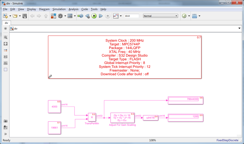

Please help trouble shoot code(a function and its call) below. why I got dutyU, V & W all equal to zero?
And would please provide a piece of suggested code to calculate: 4000*(19661/65535), the 3 numbers for in all integers(uint16), and the result should be integer(uint16) too, for MPC5744P motor control using S32DS.
FLEXPWM_set_duty(19661, 19661, 19661);

Hi liwuquan‌,
Just be careful that AMMCLIB functions need signed inputs. Most likely you so not get the correct answers due to the type casting - i presume the compiler informs you about that.
Why don't you try something simpler like this: multiplication followed by right shifting 16bits
Hope it helps!
