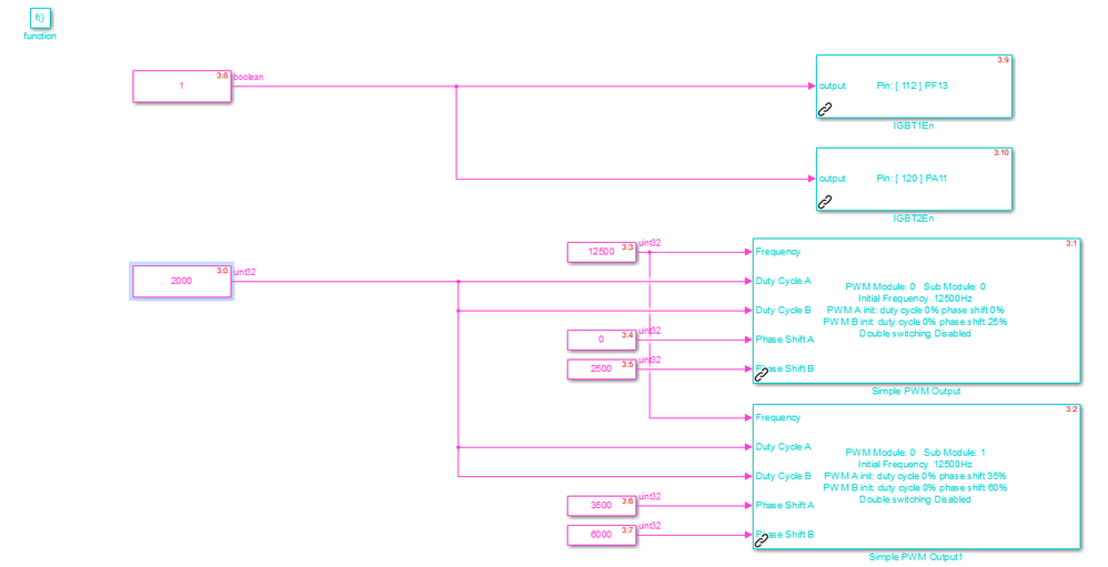

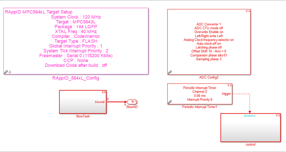

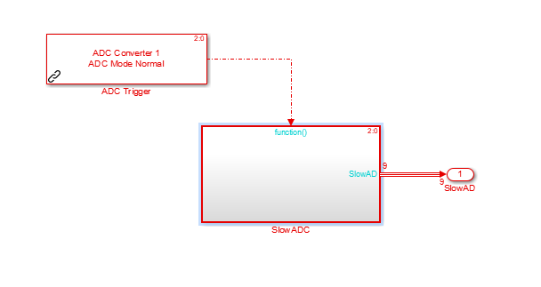

First,I creat a model in the simulink by MCToolbox for mpc5643l.I upload the model file in the accessory.
Second,I build the model without any modify.Through click the build button,the elf file automatic generate.

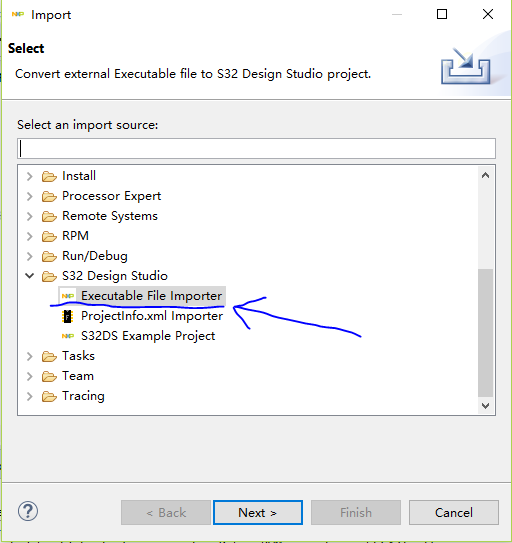

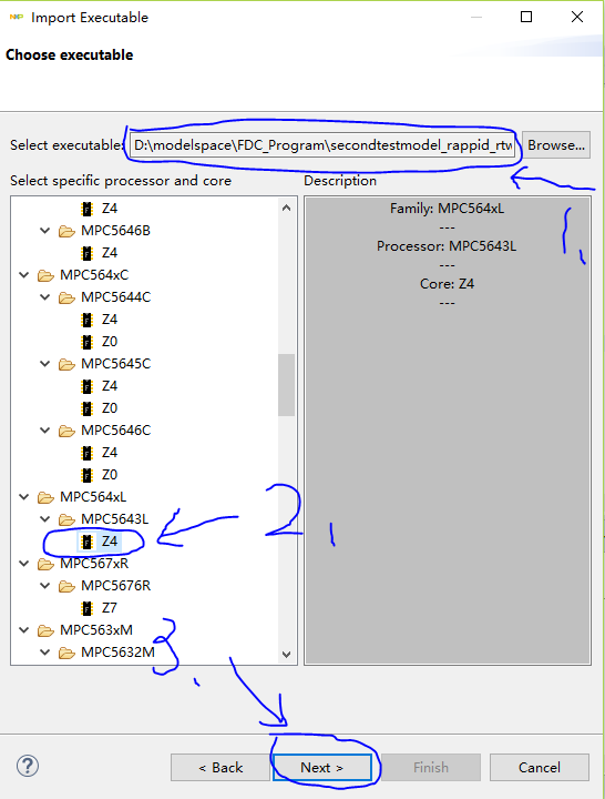

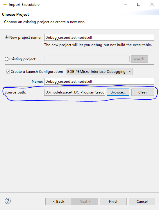

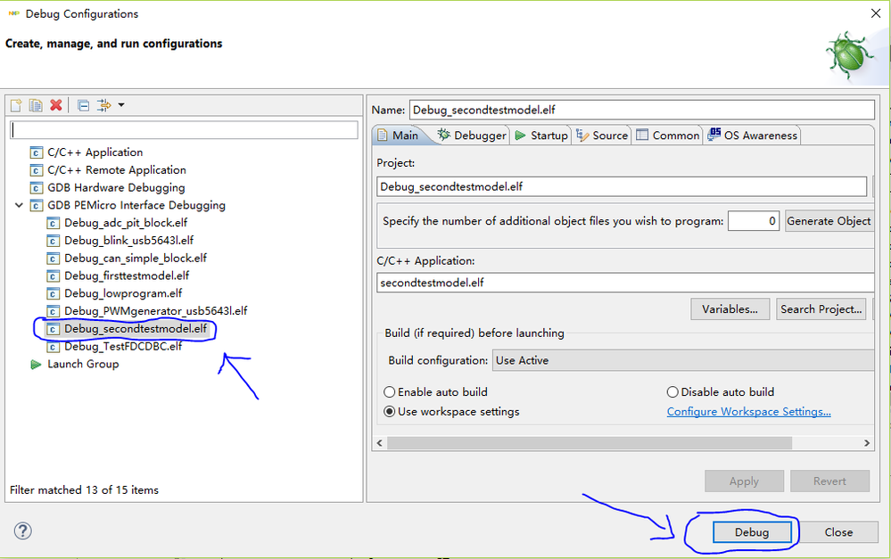

Third,I download the .elf file to the trk-usb-mpc5643l through the S32DS for power by Executable File Importer.
Fourth,I debug the program by S32DS.In the debug interface,I click the run button.The program can run without any error.

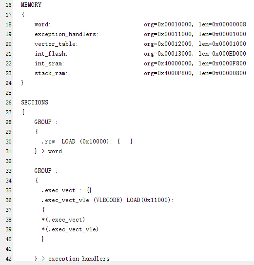

Then I modify the MPC564xLFlash.lcf and secondtestmodel.mk file.
In the secondtestmodel.mk,the old version
the new version
In the MPC564xLFlash.lcf,the old version
the new version

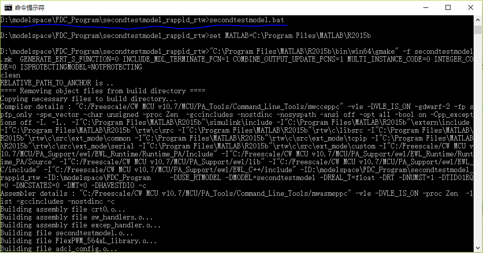

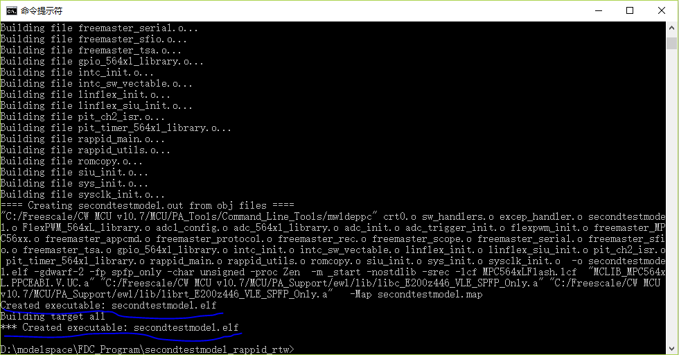

Then I use the cmd to build the program.
the build successful

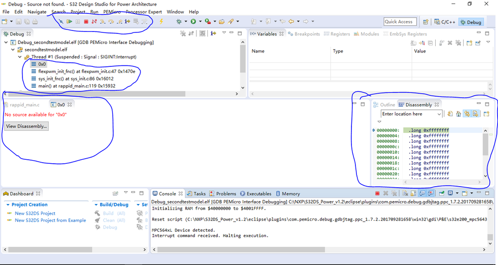

Then through the above method,I download the program to the board and debug the program.
In the debug process, I click the run button,after several seconds,I click the suspend button,the program run to 0x0.
