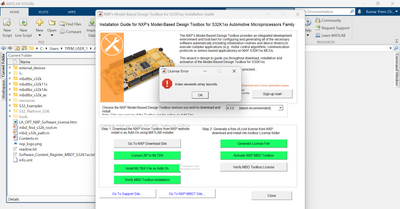

Hi NXP Team,
Need your support.
1) I have successfully installed MATLAB 2022b.
2) Then, installed the NXP Toolbox and verified too.
3) For License verification, I am facing the "Model-Based Design Toolbox License Missing" and the window says "please go to Model Based Design Toolbox Website". Please see image below.
I have also followed the above steps, mentioned by Mr. Razva.
But still, I am facing the " License Missing Issue". Please help.
Note: The license file Name  is  - License and file format = .dat and complete file name = license.dat

dmorvay
Hello, I am receiving the following error: License Error: -1, Model-Based Design Toolbox License Missing, please go to The Model-Based Design Development Toolbox Web Site to get a free license or request a demo. Provide the following HostID:
I am on Matlab 2021b and the Model Based Design Toolbox S32K1xx 4.3.0. My license.lic is in the lic folder as well. Any ideas on how to solve this problem are appreciated.
14,193件の閲覧回数
mariuslucianand
Hello @dmorvay,
Please type the following command inside the following command in MATLAB Comand Window  winopen(fullfile(mbd_find_s32k_root, 'lic')) and check if the license is there.
Alos, please check with .dat extension instead of .lic.
Hope this helps,
Marius
14,191件の閲覧回数
dmorvay
Hi Marius,
It looks like changing the file back to .dat extension solved the issue. Thank you!

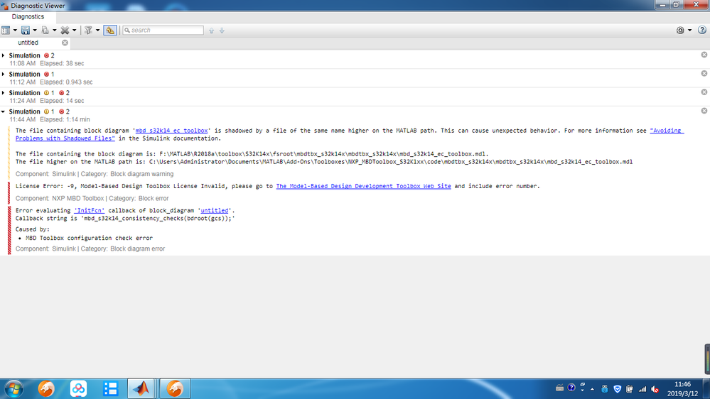

bamboo
hello John:
   This is my add path and error display, just like yours.
16,234件の閲覧回数
john_yang
Hello Xiaoning,
It looks like yours is different from my licensing problem. Mine was caused by our internal network firewall. I guess you have multiple installations that confuses Matlab.
John
16,234件の閲覧回数

bamboo
hello  Razvan:
I operate according to your video, but the result is reported to error-9, which means license invaild. I don't know why.
16,234件の閲覧回数

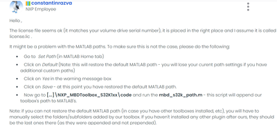

constantinrazva
Hello [email protected]‌,
The license file seems ok (it matches your volume drive serial number), it is placed in the right place and I assume it is called license.lic .
It might be a problem with the MATLAB paths. To make sure this is not the case, please do the following:
  •    Go to  Set Path (in MATLAB Home tab)
  •    Click on Default (Note: this will restore the default MATLAB path - you will lose your curent path settings if you have additional custom paths)
  •    Click on Yes in the warning message box
  •    Click on Save - at this point you have restored the default MATLAB path.
  •    Now go to [...]\NXP_MBDToolbox_S32K1xx\code and run the mbd_s32k_path.m - this script will append our toolbox's path to MATLAB's.
Note: if you can not restore the default MATLAB path (in case you have other toolboxes installed, etc), you will have to manually select the folders/subfolders added by our toolbox. If you haven't installed any other plugin after ours, they should be the last ones there (as they were appended and not prepended).
Please let me know if this works,
Razvan.
