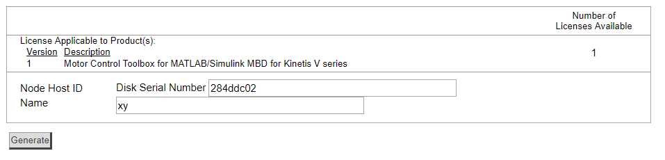

I generated a license file with my host id, which is shown here:

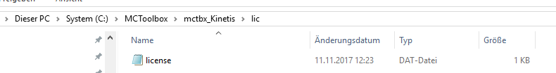

The generated license.dat file is stored in the correct directoty:
The toolbox is installed in the standard folder: C:\MCToolbox

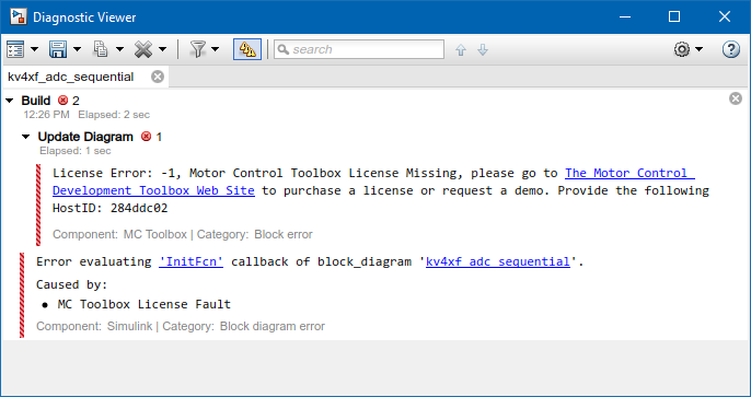

But I still get this error message while building the model:
I have restarted MATLAB and windows.
Please give me some instructions... I don't have any idea anymore.

Hi lethuer‌,
Can you please change the license file extension from .dat into .lic
That should make it work.
Hope it helps!

lethuer2
You are right !
Thank you very much :smileyhappy:
