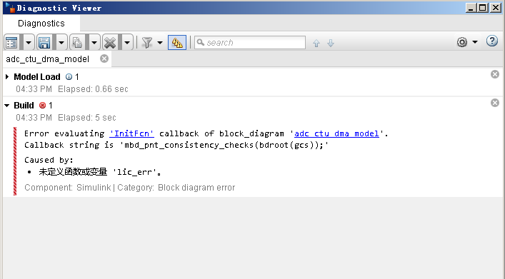

Build 1 Clear 10:05 AM Elapsed: 3 sec Error evaluating 'InitFcn' callback of block_diagram 'adc_model_pnt'. Callback string is 'mbd_pnt_consistency_checks(bdroot(gcs));' Caused by: 未定义函数或变量 'lic_err'。 Component:Simulink | Category:Block diagram error
matlab 2018    mbdtbx_MPC574xP
#Model-Based Design Toolbox for MATLAB/Simulink - Model Based Design Toolbox #for MATLAB/Simulink MBD supporting MPC574xP for shuigen li Software Account # License for DISK_SERIAL_NUM=507b9d0bd803 lsg INCREMENT MC_Toolbox_574xP freescale 1.0 permanent uncounted \      VENDOR_STRING="Model Based Design Toolbox for MATLAB/Simulink \      MBD supporting MPC574xP" HOSTID=DISK_SERIAL_NUM=9d0bd803 \      ISSUER="Freescale Semiconductor" ISSUED=10-dec-2018 ck=219 \      SN="FSL - 25310317" TS_OK SIGN="10CE 5F02 DD4D 6921 08B4 264E \      D29C D203 F846 729A E225 5463 6F7E D088 5C54 1F8E 54F7 CDC4 \      186E 6AC6 CB45 9B4D 37BD 4EC7 3D24 846A 135D B6F2 927B 6EFE"
i have update mbd_pnt_hostid.p . nothing is happend...thanks!

Hello [email protected]‌,
Here is a video showing how to generate a license - it's demonstrating for S32K14x toolbox, but the process is the same for MPC5744P. Could you re-generate a license, following those steps? And then copy it in the lic folder?
From what I understand, you already updated the mbd_pnt_hostid.p file, right? After you get your license working, you should also take a look at other hotfixes (here) for MPC5744P toolbox. Keep in mind that in the 2nd part of February we'll release a new version of the MPC5744P toolbox - it will be based on P.A. SDK and will support other derivatives as well as parts of Calypso family (MPC574xP|B|C|G).

I setup the MPC574xP toolbox again following those steps.then i open a example ,build it ,a question like:
thanks!
i can not set  system environment ,like :pastedImage_2.png
this for s32,what is for MPC574xP.
thanks!!
