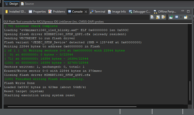

Using MCUXpresso and the MCU-Link, I can flash to the board without issue:
Instructions followed in:
"Quick Start Guide for how to use the toolbox with a custom board"

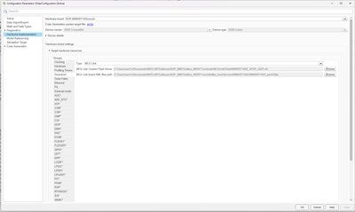

Here's the setup in Simulink:
The XML are generated from MCUXpresso and attached.  The default XML's provided with the Toolbox don't work either.
What needs to be changed in the part information directory?
