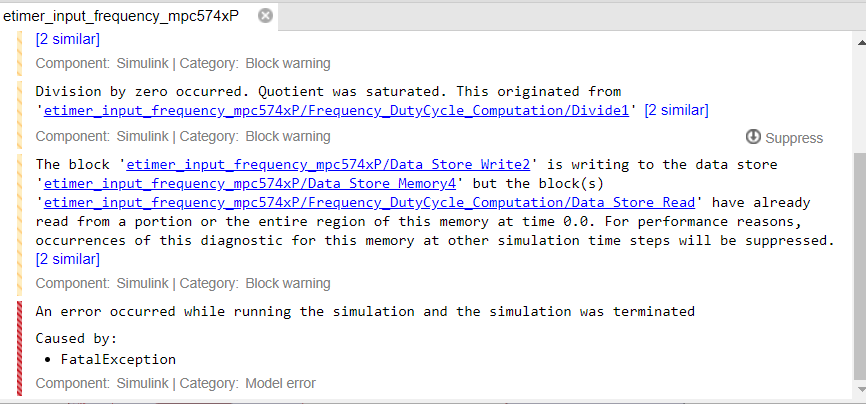

I am using the Devkit MPC5744P Rev B and the Model Based Design Toolbox 3.0.0.  When I run the example about "etimer" in matlab(matlab2017B) simulink,it shows error:
The block 'etimer_output_frequency_mpc574xP/Data Store Read1' is reading from the data store 'etimer_output_frequency_mpc574xP/Data Store Memory' before any blocks have written to this entire region of memory at time 0.0. For performance reasons, occurrences of this diagnostic for this memory at other simulation time steps will be suppressed. [2 similar]
Component:Simulink | Category:Block warning
An error occurred while running the simulation and the simulation was terminated
Caused by:
FatalException
How can I solve this error.
thanks.

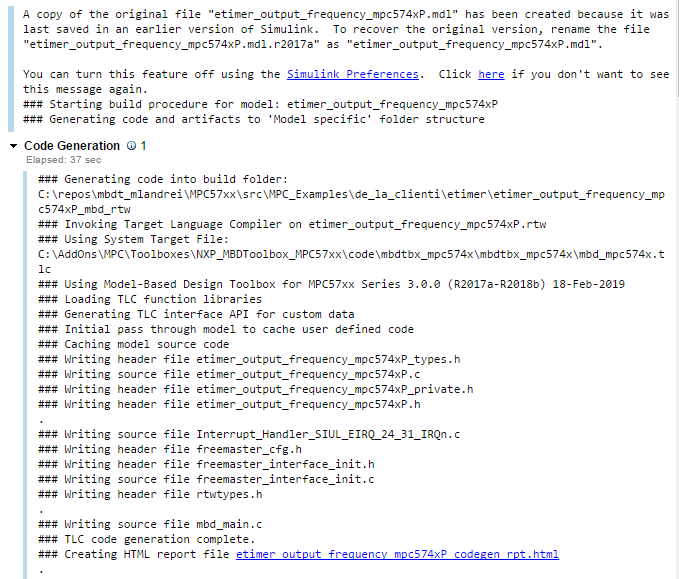

You encounter a very strange error. In my case, the examples attached by you, taken from our toolbox, worked perfectly.
I would suggest to delete the .mdl.autosave file.
Have you tried other examples? Do they end up with the same error?

Do you run this model in simulation? Our blocks are mainly designed to run in code generation and suppose to produce no output during simulation, because we can not simulate the e200 core and the peripherals.

Yes,  The simulink will be abnormal terminated when I run the simulation which is including the Etimer module.
So, etimer blocks is cannot run in simulation. but the other blocks can run normally.
I always run the simulation in order to check my  modeling for errors.
Because it usually takes a long time to generate code to report errors.

Oh, I see now, well, we will investigate this issue and provide a fix in need be these days.
