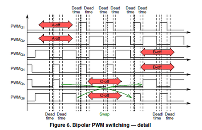

hayaoki7
hello,
I want to set the PWM of the BLDC motor in the attached image.
Taken from Freescale AN1916.
To do this, you need a PWM mask and swap.
PWM of MC56F8xxxx has mask and PWM, so it should be possible to deal with it.
If you can use this, you will be able to move in complementary mode.
Is there a way to do this with a model?
thank you.

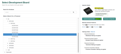

From this post  I see that you want to use a different hardware part of MC56F81000 family (the MC56F81666VLF). I don`t know if you managed to insert the SDK correctly in the toolbox, but I will explain to you step by step how this can be done.

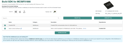

1. In the MCUXpresso SDK builder after you choose the hardware part from Proccessor -> dsc tab and then select the hardware part you want to build the SDK, you also have to select all the additional packages that are supported for the version 2.7.3, including FreeMASTER, because we use those middlewares in our toolbox.
2. After you download the SDK, you have to extract the content from the zip file into a new directory "{toolbox_path}\NXP_MBDToolbox_DSC\DSC_Platform_SDK\SDK_2_7_3_MC56F81666"

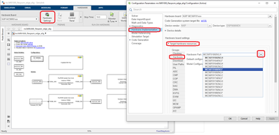

3. When you open a model, for example the mc56f81000_flexpwm_edge_aligned.mdl, you have to change some settings from the Hardware Settings tab. In the Hardware Implementation -> Target hardware resources -> Hardware you have to choose your Hardware Part, which is going to be MC56F81666VLF.

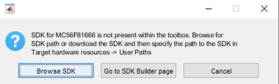

4. After you have done that, a pop-up will show up to warn you have to tell a path to the SDK folder that you have just download and extract in the step 2.
5. Then you will click Apply and save the model.

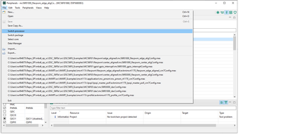

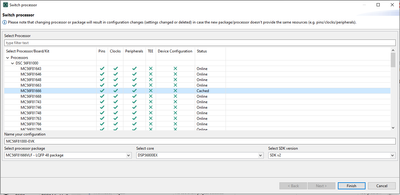

6. In order to build the application successfully, you also have to do some changes in the mex Configuration Tools file attached to the model. For that, please open outside MATLAB the mc56f81000_flexpwm_edge_aligned.mex and go to File -> Switch processor
7. From here, you also have to look up and choose for your hardware part, as shown below. And then clcik Finish.
8. From this point, if any errors appear in the current configuration, you have to resolve them by yourself in order for a successful build. Then you will save the configuration file and try to build the model.

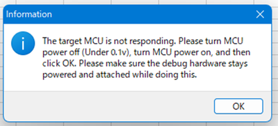

hayaoki7
hello
MC56F81000-EVK made the target change as you sent, and was able to build and download to the target. I just have a problem. Download to target fails frequently. At that time, an error as shown in the figure appears. Is there any way to solve this? Any good ideas?
Also, I found that R2022B can not be built. Is there any way to improve this?
thank you.
Hayaoki7
12,364 Views
stefancinipeanu
Hi, @hayaoki7
For downloading the application to the target, there are 2 downloading support methods: CW Flash and PEmicro Flash. the CW Flash is delivered together with the toolbox and the PEmicro had to be downloaded separately and integrated into the toolbox. Which method did you use? From the image that you have sent, I assumed that you`ve used the PEmicro Flash. Did you try also with the CW Flash?
As a quick info, to change settings for downloading the application, you have to go to Hardware settings -> Hardware implementation -> Target hardware resources -> Download
For the other issue that you`ve mentioned, I`ve tried to build an example in R2022b and I had no problems with building and downloading the application on MC56F81000-EVK. What issues do you have on R2022b?
Stefan.

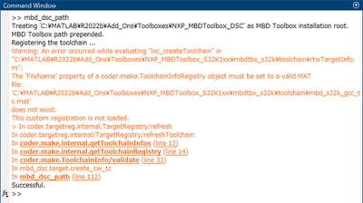

hayaoki7
hello
My MATLAB R2022B has S32K1 and DSC set up. Running mbd_s32k_path gives no errors. I get an error when I run mbd_dsc_path. Does this error prevent the build?
Also, is there any way to avoid this error?
thank you.
Hayaoki7
12,253 Views
stefancinipeanu
Hi, @hayaoki7
Sorry for the late response. I have been investigated the issue that you`ve encountered and it seems that you are right, the model that you have sent and also some others from our toolbox examples are no longer building in MATLAB R2022b.
The reason for this issue is that for PWM peripheral, we use some values defined inside the peripherals.h file which is generated by the MCU ConfigTools using the mex file attached next to the model. This header file along with others (peripherals.h, board.h, clock_config.h, and pin_mux.h) are included inside the MW_target_hardware_resources.h file (generated by the Embedded Coder). In older versions of MATLAB, this MW_target_hardware_resources.h header was included inside the generic header file <model_name>.h, but in R2022b the resources header is now present inside the ert_main.c file and that`s why the compiler does not see the defines from peripherals.h anymore. We have to investigate further to find a stable solution for this kind of issue.
Meanwhile, as a quick workaround, I will attach to this post a zip containing a file that you have to copy to the following directory path: {toolbox_path}\mbdtbx_dsc\blocks\flexpwm
What I have done was to force the inclusion of peripherals.h header where those defines are.
Sorry for this inconvenience. I am going to open a ticket for this. Let me know if this workaround works for you.
Stefan.

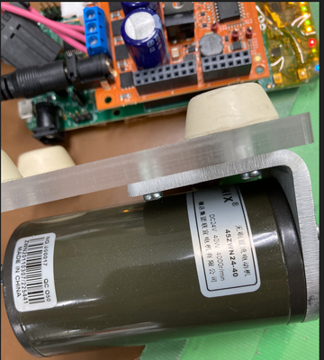

hayaoki7
Hello
I was able to build it. Thank you.
I downloaded it to the target and did a PWM operation test.
The test used the motor in the photo.
R2022B: Motor does not move.
R2022A: Motor has run.
I've attached a photo of the motor I tested. I expect improvement.
thank you.
Hayaoki7
