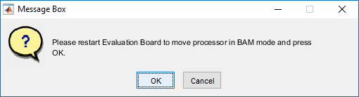

1. I would be sure that the code reaches the flash. For that have you flashed the srec bootloader on the board using S32DS? In order to transfer the mot file, the board must run the bootloader. Have you restart the board and press the "OK" in the following attached window? Also please follow if the RAppId bootloader erases and the uploads the code.

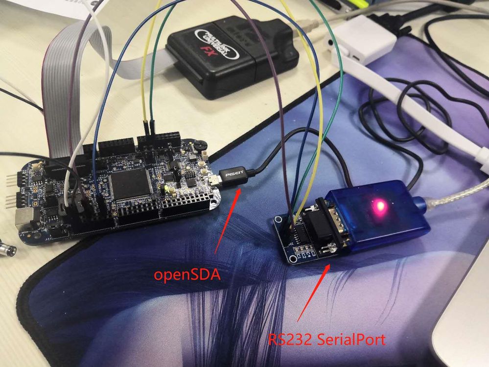

Actually I connect the EVB to PC in two ways. The first way is to connect PC through openSDA and microUSB , the other way is to add a dupont line to connect the MCU pin and RS232 converter, and then connect to the USB port, which is a Serial Port, as the picture shows below.
I found that if to communicate through openSDA , it works fine. But if to communicate through SerialPort, it cannot work.
And when flashing srec file into the MCU with bootloader, it is fine to flash through openSDA but not fine to flash through SerialPort.
Can we flash the file with bootloader through Serial Port? You know, if we design the circuit board by ourselves, the bootloader should be through the Serial Port.

Now I understand your problem. So you need to use insted of the OpenSDA's USB2Serial an RS232 converter because on the custom board that you are about to design you will not have an OpenSDA. There should be no problem in this setup as long as you use the same PD9, PD12 pins from Serial1 as RX/TX for bootloader.
The reason why your current approach is not successful is that the PD9 and PD12 pins are already connected at the OpenSDA and on this board, the OpenSDA can not be unplugged from power. Long story short, the end to end Serial connection is already done so you can not connect a third participant.

I unplug the microUSB connected to the openSDA and it works well.
But I also found that the duport line connecting the LIN0 and LIN1 cannot be unpluged. So, is the LIN0 necessary in bootloader process? Maybe it is the LIN0 that works in the process? Could I only connect the LIN0 to the Serial Port in bootloader process?

The current bootloader only works on PD9,PD12/Lin1 over Serial connection because this one is connected to OpenSDA.
But, if you want to use the Lin0(PB2 and PB3) pins, in the installation folder (src\tools\BootLoader\RBF_Files) you will find other bootloaders for MPC5744xP. You can try the MPC5744P.rbf or MPC574xP.rbf by flashing them using S32K because one of them might work using Lin0 pins.

As you taught, I have tried three rbf files: MPC57x4P.rbf , MPC5744P.rbf , and MPC5744P-Devkit.rbf .
The result is that the MPC57x4P.rbf and MPC5744P.rbf works with LIN0, while MPC5744P-Devkit.rbf works with LIN1.
Now I am able to flash the applicaition srec with bootloader through LIN0 and SerialPort.
