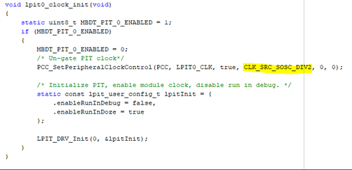

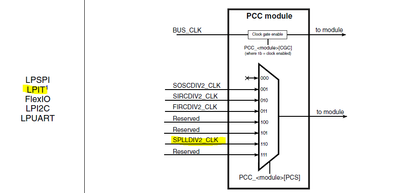

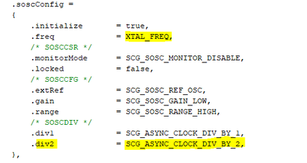

1) For both profiling methods(using Profiler block and Simulink profiler) the LPIT0 timer is used. Looking inside s32k_clock_config.c file where all clocks are configured, I have noticed the following:
  • for S32K11x: the source clock for LPIT0 timer is SOSCDIV2 clock that derives from DIV2 that is set to 2. SOSC_CLK is configured to use the XTAL frequency. In all our examples, XTAL frequency is 40MHz. So in this case, 1 tick duration is going to be 50 nsec (SOSC_CLK/2 = 20 MHz).
stefancinipeanu_0-1682326357988.pngstefancinipeanu_0-1682326357988.pngstefancinipeanu_1-1682326404529.pngstefancinipeanu_1-1682326404529.png

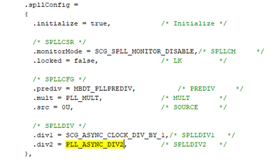

  • for S32K14x: the source for LPIT0 timer is set to SPLLDIV2 clock, which is derived from SPLL clock (80 MHz). DIV2 field from the SPLL configuration structure is set to PLL_ASYNC_DIV2 = 4. So, 1 tick duration is also 50 nsec (SPLLDIV2 = SPLL_CLK/4 = 20 MHz), in the case of Core clock frequency of 80 MHz.

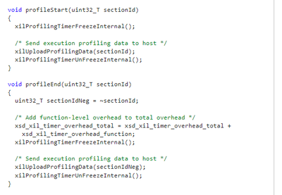

I apologize for my late response. I have investigated your model and I am not quite sure how did you obtain those results displayed on the scope from the profiler block. What I have done is to create a new model and use FreeMASTER to check out the results that profiler block has returned, like in the image below:
Comparing the results between profiler block and PIL profiler functionality, you are right. There are different values because PIL profiler introduces a lot of overhead and I had already open a ticket trying to resolve it. For the moment, I suggest to use profiler blocks because they are more accurate and also I might suggest to modify the compiler flag for optimization from -O1 to -O0 for better accuracy when measuring the time execution of a portion of code.
When using the profiler block, the generated code for your subsystem/model will be put inside the function calls that will get tick values from LPIT timer.
But when using PIL profiling functionality, there are a lot of calls until it gets to use the LPIT timer to get the ticks, because the code for PIL is generated differently than an usual model building. For example, below you can see the functions used to profile the code in PIL for your model that you`ve sent me and those profilerStart and profilerEnd functions will call another functions in cascade to actually measure something and then uploading the results in Simulink. So we can observe the introduced overhead from this cascading function calls.
