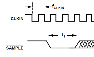

There is a need to use some port timing config in my MBD simulink(devkit MPC5744P).
So I want to use matlab function. But I don't know how to config the time accurately,for example ,the t1  in the following picture.
I have used the nop() in my matlab function , but it seems not work.
Can you give me some advices?

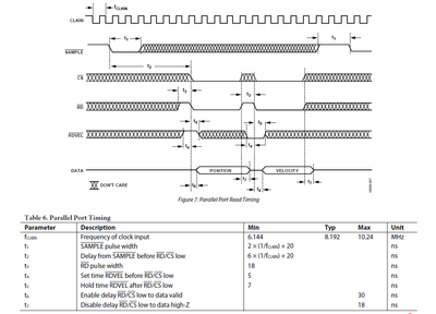

I have tried to use matlab function to do the port timing.
But  it seemed not work.
In the matlab function ,The actual hardware pin voltage level does not change with the code.
If I used the PIT,how to realize it ?
Can you explain it a little bit more?

What I want to know is that if have a C code(like _nop() or dely function) can be used in the  matlab function to make a accurate time dely.
Beacuse I want to config a port timing like following.
If there is no such C code , can you tell me further how to implement it by the MBD.
I have used the stateflow to test it.
It seemed that the timing is not accurate.
Thank you very much.
