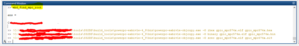

mariuslucianand
Hello @youngkugpark ,
MBDT comes with native support only for the FreeMaster tool. You should also be aware that there is a second option for the FreeMaster, which is called FreeMaster Lite. Maybe this will help you.
I don't know how the ETAS INCA works so I am afraid that I can not help you with that...
Now for generating the hex/bin/s19 MBDT comes with the compiler files so you have to press the following commands in order to get the desired files.
Run the mbd_find_mpc_root command to find the install path of the MBDT. With that path you can type the following command "{Path}\tools\S32DS\build_tools\powerpc-eabivle-4_9\bin\powerpc-eabivle-objcopy.exe -O ihex gpio_mpc574x.elf gpio_mpc574x.hex" to generate the hex file.
If you want to embed all of the above commands in the Makefile and to create them automatically, please go to {Path}\mbdtbx_mpc574x\mbdtbx_mpc574x open the mbd_mpc574x.tmf and add the desired commands starting with the lines 558
Hope this helps,
Marius

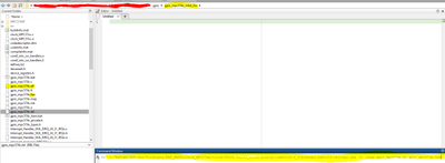

mariuslucianand
Hello @youngkugpark
Apparently, there is more to change than that.
Let' try to generate them manually. For that go to the _mbd_rtw generated folder
Run the mbd_find_mpc_root command to find the install path of the MBDT. With that path you can type the following command "!{Path}\tools\S32DS\build_tools\powerpc-eabivle-4_9\bin\powerpc-eabivle-objcopy.exe -O ihex gpio_mpc574x.elf gpio_mpc574x.hex" to generate the hex file or the extension that you are interested in.
Hope this helps,
Marius

mariuslucianand
You have to replace the {Path} with the output of the mbd_find_mpc_toolbox.
You have to open the gpio_mpc574x_mbd_rtw folder with the generated code  just like in the image below.
For you, the command should be like this
!C:/MATLAB/ADD-Ons/Toolboxes/NXP_MBDToolbox_MPC57xx/tools/S32DS/build_tools/powerpc-eabvile-4_9/powerpc-eabvile-objcopy.exe -O -ihex gpio_mpc574x.el gpio_mpc574x.hex
Hope this helps,
Marius
