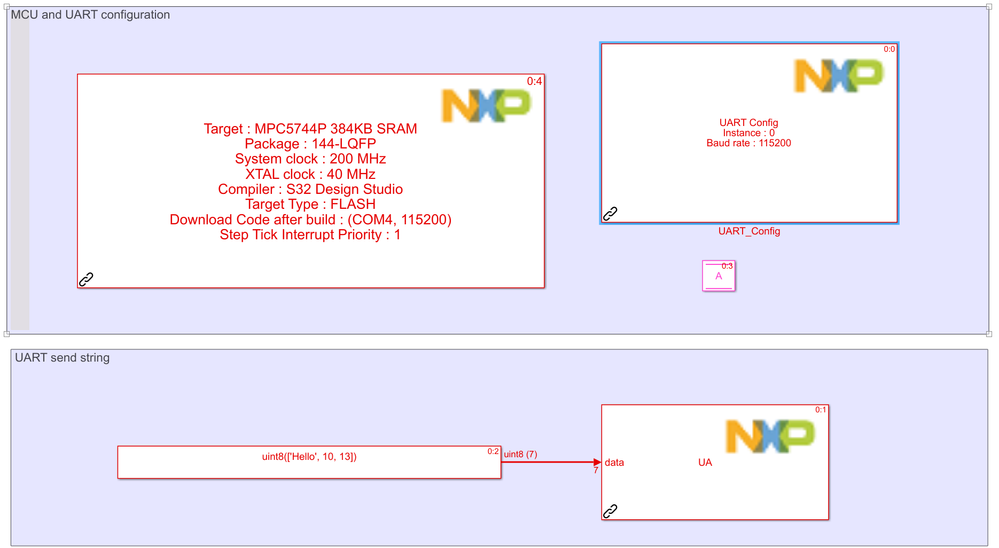

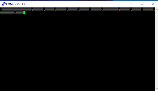

It is impossible to recognize messages which sent via UART (uart_hello_world_mpc574xP model) from MPC5775B BMS Plus VCU Reference Design board.

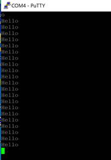

There is no any problem when same model is used together with DEVKIT MPC5744P.

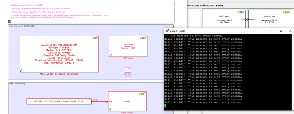

Hello @sonik82 ,
We have a model in the toolbox for the MPC5777C which is basically the same as the MPC5775B that you are trying on. I see no problems with this one. Can you please give it a try? Also, I've uploaded the model here.

@mariuslucianand  Thank you, uart_hello_world_mpc5777C works fine.
