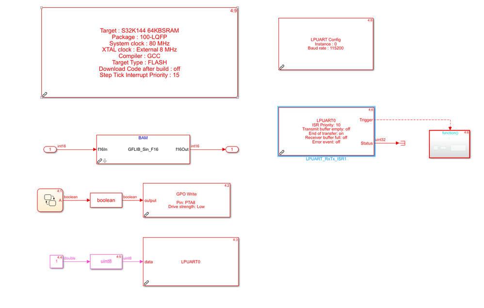

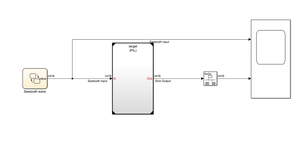

I am new to using the MDBT toolbox for S32K144 on matlab for creating applications. I am facing difficulties in using interrupt routines inside the PIL model block (which contains the code to be executed on the microcontroller). Here are the screenshots of my model. I am trying to toggle a LED on UART transmission complete.
Top Model
PIL Block
The error which I get
The same error is reported even for any other interrupt I have tried to create. Seems like I am unaware of the methodology of using interrupts in PIL simulaiton.
Step size for both models is same (0.01 Sec)
To sum up, I want my embedded system to partially run on PC to design and tune my control algorithm while also been connected to microcontroller for sensor interfacing (which uses interrupts; for data acquisition and actuation).
I will highly appreciate any help on this issue.

Daniel_Popa
Hello all,
We are currently looking into this issue. We were able to reproduce the issue and we are trying to understand the root cause.

13226508
I have encountered the same problem with you. Have you solved it?
