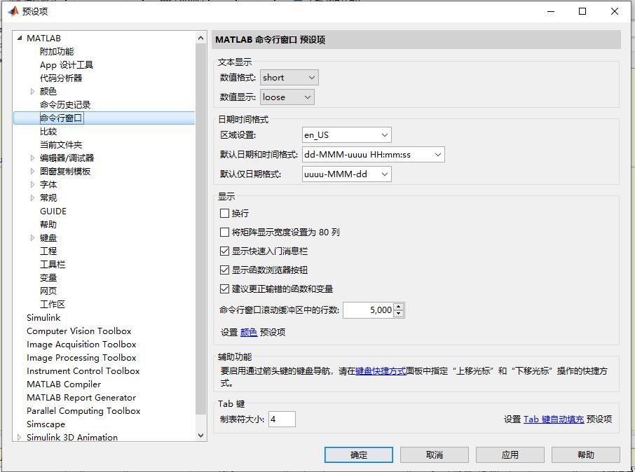

According to your prompts, I modified the preferences of Matlab, as shown in the figure below.But the same problems still arise.
12,963 Views
nxa11767
A restart of the matlab did not work? If you see the same error that mentions 'zh_CN' then it might not applied the changes done in preferences. Also delete the generated <model_name>_ert_rtw folder, and any cached data of the model. Also, after changing the locale data time format in preferences, run again the mbd_kvx_path.m script.

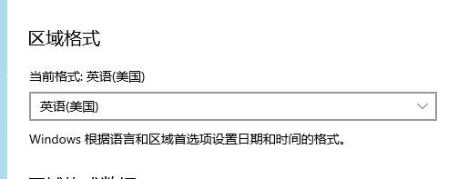

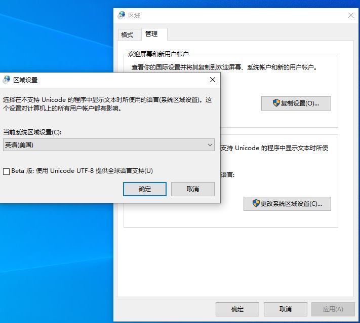

After careful study, I found that the time and area format Settings in Matlab should be consistent with the system Settings.Change the time format Settings in the operating system
I run the MBD_KVX_PATH. M script and the output was successful

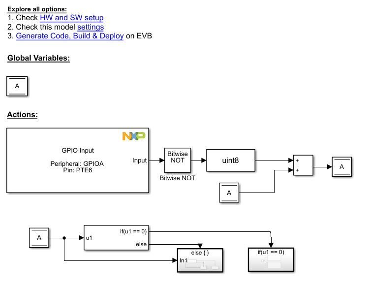

The frdmkv31f_gpio_pollingconfig.mex  should be next to your model. Like in below screenshot:
Browse to the example folder and you should see it there. On a clean installation the .mex is not there, but will be copied when the .mdl is opened. Some examples will have a .mex associated because those example have particular settings exactly for that example.
After build, you'll see two folders being created: frdmkv31f_gpio_polling_ert_rtw and frdmkv31f_gpio_pollingConfig. Delete these folders and try again. From your screenshot I can see that the processor data was loaded correctly in the Configuration Tool and I don't see any errors when the model mex was opened.

As for the problem that the time format cannot be recognized, I would like to share my experience. If it is a Chinese operating system, then the system Settings and MATLAB Settings should be shown in the following figure.
