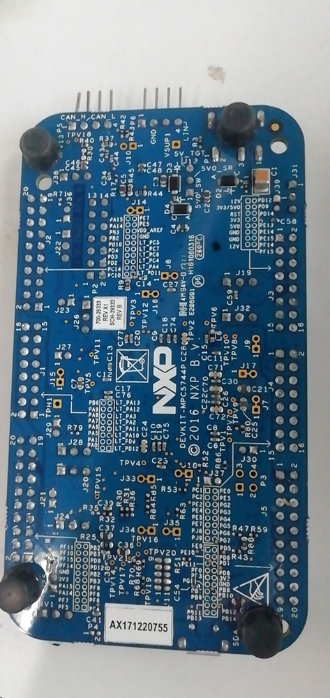

mariuslucianand
Hello [email protected]‌,
Which MPC5744P dev board are you using, is it RevE or the previous one?
Marius
5,482 Views
lijiantaowy
Hello mariuslucianandrei
 I have another problem here. I wrote a motor control program according to the official example. What is the difference between 1 and 2 in the selection card below? When I select 1, set the step size to 0.001 in the simulink configuration. When the priority is lower than the FIFO interrupt (the period of the FIFO interrupt is 100us), the freemaster can't communicate with the MCU. When the priority is greater than the priority of the FIFO interrupt, the freemaster can communicate with the MCU. When I select 2, the freemaster cannot communicate with the MCU. In addition, when I set the step size to 0.1 in the simulink configuration, the program control effect is very poor, the current loop control program is placed in the FIFO interrupt processing, what is the relationship between this PIT0 interrupt?
