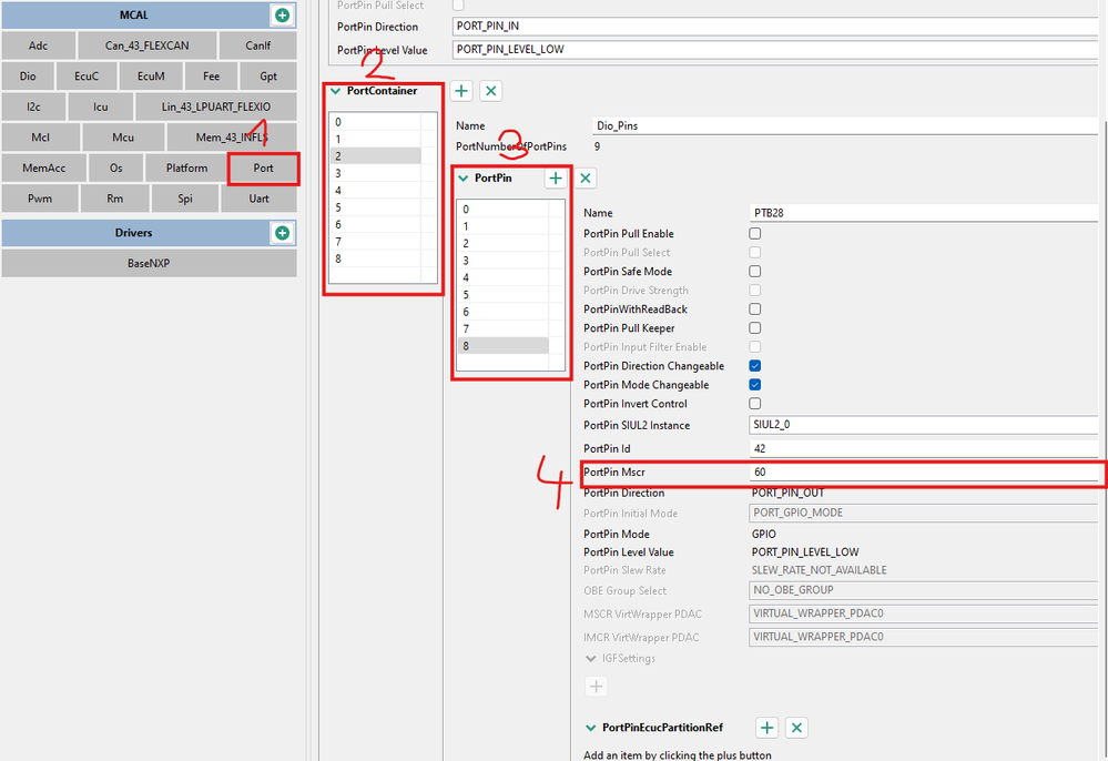

There is one thing I missed yesterday to check.  Apart from the pins and DIO component, you also need to configure the Port component to use the specified pin. Since you are using a older version of the toolbox, the port pin is not automatically updated based on the Pins configuration (and that is why it works in S32DS).
To sum up:
1. Open the configuration project and navigate to the Port component.
2. In the Dio Port container, add a new Port Pin with the MSCR of the pin you want (in this case, for PTB28, MSCR is 60).
Let me know if this solves your problem.

chaudharimohit73
Yes, now Dio problem is solved and working as expected.
