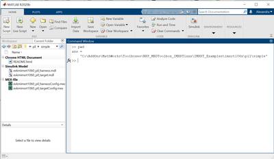

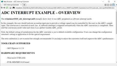

In SiL_harness example, when we click on "HW and SW setup", I got document of another example "
ADC INTERRUPT EXAMPLE
2,323 Views
nxa11767
Hi Sutter,
We are aware of this limitation - you need change the current folder in your matlab to the location of the model and then it will open the right README.html.
