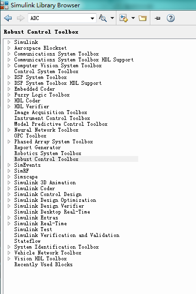

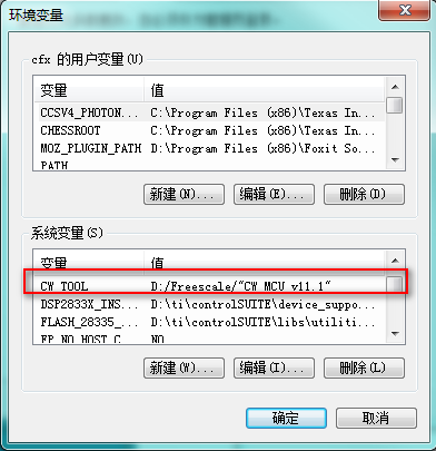

     I want to use a MC9s12zvm MCU for motor control with MBD approach.  First, MCToolbox and mcd_s12z_path.m are loaded into matlab. Then the freescale CW MCU v11.1 is installed. I also added the enviroment variable : CW_TOOL = D:\Freescale\"CW MCU v11.1". However, when the examples model, adc.mdl, is building, the build error has happended. ‘### Build procedure for model: 'adc' aborted due to an error.’ is found in Diagnostic Viewer.  all diagnostic message is added to the appendix. Thus, how to solve this problem? or this model has been built successfully?.  Besides, NXP Toolbox is found in Simulin Library Browser. So, how to creat a toolbox?

Another thing I'd like to mention - could you set the CW_TOOL to D:\Freescale\CW MCU v11.1 instead of D:\Freescale\"CW MCU v11.1" ? (without the "").

         When the  D:\Freescale\CW MCU v11.1 instead of D:\Freescale\"CW MCU v11.1", the model has been build completed successfully.Thanks You!
