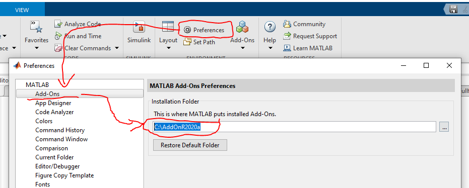

mariuslucianand
Hello @Poley
From the attached logged I've noticed that the toolbox has been installed in a path that contains some spaces:
 Warning:Environment Variable GCC_S32K_TOOL was not explicitly set. The generated code will be compiled using the default GCC compiler C:\Users\Matt P\AppData\Roaming\MathWorks\MATLAB Add-Ons\Toolboxes\NXP_MBDToolbox_S32K1xx\tools\gcc-6.3-arm32-eabi
 So let's try installing the toolbox in a path without spaces like: "C:\MATLABAddOns"
You can specify to MATLAB which path to choose for toolbox installation by going to Preferences -> Add-Ons and type your desired path. Please use one with no spaces.
Hope this helps,
Marius
