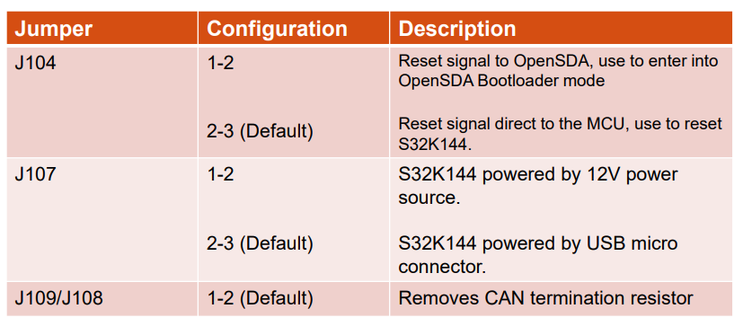

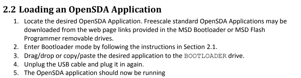

sparkee
Contributor V
As luck would have it, I bricked the board today.  It would not come out of bootloader mode.  It wouldn't take new bootloader firmware.  It wouldn't respond to the Mutlilink Universal programmer.  It wouldn't respond to the Kinetis software to fix the bricking.  12V power, USB power, didn't matter.  I messed with it for 3 hours, pouring over every post about a bricked device.  I was finally able to get the BOOTUPDATEAPP to take, then it took the 1.19 bootloader firmware, now everything is working great on USB power and OpenSDA is programming from Simulink.  Like it's fresh out of the box again.  I'm so happy slash worn out.

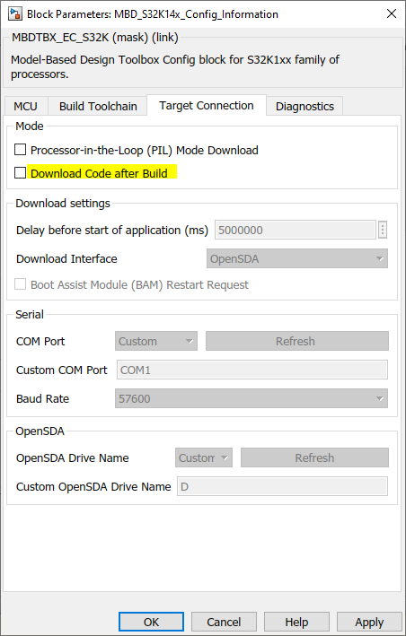

constantinrazva
Hello sparkee,
So are you finally able to program the EVB directly from Simulink? That would be great news to hear, knowing for how long this issue has persisted.

sparkee
Contributor V
I'm back to a bricked unit.  It worked so well all day.  I left my computer for a while and it went to sleep.  When I came back, the board was no longer communicating.  I unplugged and replugged and it would no longer recognize the device.  I immediately started in boot mode and dragged over the BOOTUPDATEAPP file.  When I cycle the plug it isn't recognized by my computer and I get 2 green LEDs and 1 red LED.  No SDA drive on my computer at all.  I've tried it 3 times just to be sure.
11,136 Views
sparkee
Contributor V
Yes everything seems to be working great on this board.  I didn't do anything that we had not tried previously so I'm not sure why it works well now but I'm happy that it is.  I may try again with the second board to see if I get the same results.  Thank you for your support!

If you try to uncheck the Download Code after Build option from the Config Block, the Simulink still freezes? I am trying to understand if the problem is related with the code generation, building or code deployment.
Marius
11,136 Views
sparkee
Contributor V
No, everything runs as expected when unchecked.  After successful build I can drag the mot file into the EVB drive and it programs.

On the S32K144EVB there are four jumpers, that have the following functionalities. Probably the one you are referring here is the J104.

I would suggest to reflash the OpenSDA Applicationas explained by the section 2.2 from the referenced document.
