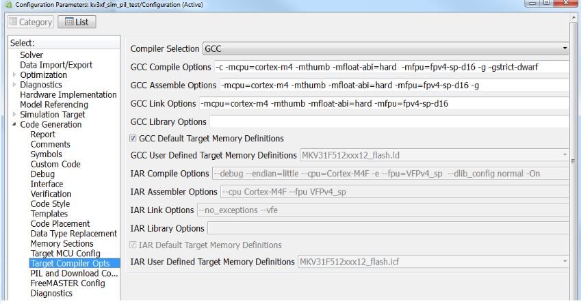

I've noticed the Motor Control Toolbox for the K V series. I was just wondering if NXP plans to update it to  v2, i.e. the Model Based Design Toolbox, which seems to be the most up to date toolbox. The reason I ask is because I'm not being able to setup PIL simulation using that toolbox, nor use the FreeMaster tool, while building any of the provided examples.
I'm using the GCC toolchain and the default linker script was not set properly, which I had to manually edit in the template makefile in order to get it to link properly. Once that was done, if I enabled either PIL or FreeMaster, which uses the UART peripheral to communicate, Matlab was not able to generate the code from the provided examples as it fails to build. I'll attach a screenshot of the errors reported below.

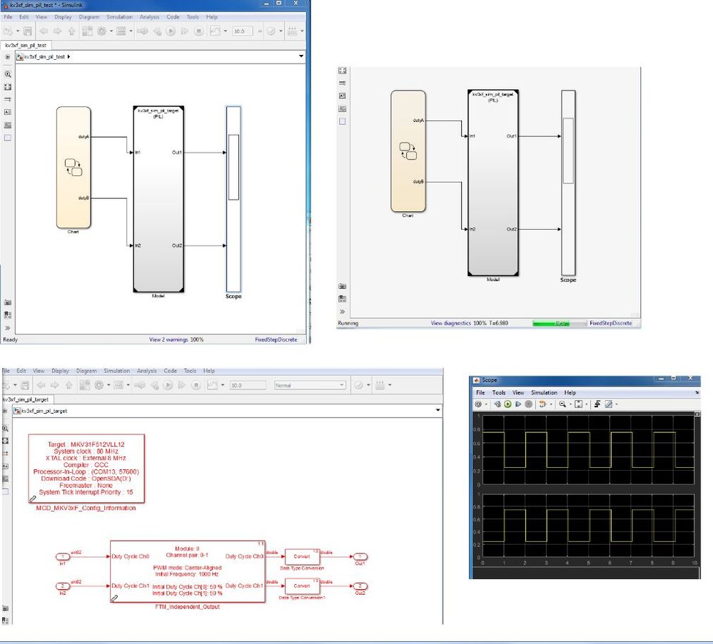

Also worth noting is that my target model looks like the following:
And if I remove the bottom "BAM" block the error related to the "intrinsic_cw.h" file goes away, therefore it must be including the header files mentioned above. However a new error occur. This new error is actually during the simulation itself as shown below:
Any thoughts on solving this one?

Maciek‌, diogocacador‌ and all the others interested in Kinetis GCC support,
We have now a solution to this problem (GCC is not supported for Kinetis devices) and could be deployed as hotfix (will become available after we finalize all tests)
For the moment if you want to try it and helps us with testing and feedback here is what you need to update:
#1: Toolbox related files to add and enable the support for GCC
1.1. Go to {Kinetis Toolbox Install dir}\mctbx_Kinetis\mctbx_kv\mscripts\ folder and replace the mcd_kv_compiler_callback.p with the one attached
1.2. Go to {Kinetis Toolbox Install dir}\mctbx_Kinetis\mctbx_kv3xf\mctbx_kv3xf\ folder and replace mcd_kv3xf.tmf and mcd_kv3xf.tlc files with the ones attached
#2: GCC support files
2.1: Copy and replace the startup_MK22F51212.S file attached to both {Kinetis Toolbox Install dir}\mctbx_Kinetis\Kinetis_Platform_SDK\platform\startup\MK22F51212\gcc\ and {Kinetis Toolbox Install dir}\mctbx_Kinetis\mctbx_kv3xf\src\gcc_specific_files\ folders
#3: Define the GCC_ARM_TOOL system variable to point to GCC compiler toolchain.
For verification we used the compiler delivered with Model Based Design Toolbox for S32K rev 2.0.0 but you could use the one shipped with S32DS IDE as well.
e.g. GCC_ARM_TOOL = C:\MBDToolbox\mbdtbx_S32K\tools\gcc-arm-none-eabi-4_9
Notes:
#1: The GCC options should be:
GCC Compile: -c -mcpu=cortex-m4 -mthumb -mfloat-abi=hard -mfpu=fpv4-sp-d16 -g -gstrict-dwarf
GCC Assemble: -mcpu=cortex-m4 -mfloat-abi=hard -mfpu=fpv4-sp-d16 -g
GCC Link: -mcpu=cortex-m4 -mthumb -mfloat-abi=hard -mfpu=fpv4-sp-d16
#2: For the moment we have validated only for KV31F family
#3: If you need to use the Automotive Motor Control library you need to get the latest version that support Kinetis families with GCC.
#4: PIL is now functional
Please let us know your results!
Thank you!
MBDT team.

Maciek
Contributor V
Hi Daniel,
after Your hotfix I'm able to build the examples that are using only peripheral blocks from KV3x. I'm building on R2016b with GCC from S32K MBD Toolbox v3.0.0.
I'm getting errors for models that are using Math and Motor Control Library blocks!
You have said:
"#3: If you need to use the Automotive Motor Control library you need to get the latest version that support Kinetis families with GCC."
I assume this is my problem.
How to get/update this library to be able to compile models correctly ?
Maciek
