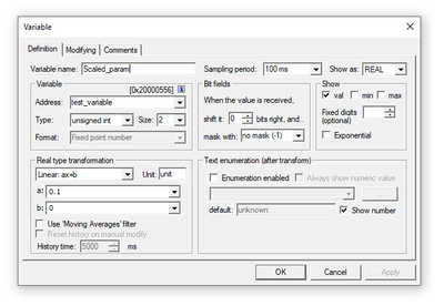

When I build and deploy the attached model to a S32K144 and connect to the MCU using freemaster there are several values that cannot be written to the "scaled_parameter" that is present in the model. The GPIO pin that is being manipulated is simply to avoid removal of the parameter by the code generation optimizations in Simulink Embedded Coder.
For example, if a real value of 0.3 (uint16 value 3) is written through the attached freemaster project's Variable Watch, a value of 0.2 is read back (uint16 value 2), there are several other values that are not possible to write.

SorinIBancila
Hello @ericrost,
I checked the attached files and I have a possible solution for you. The model seems fine and all you have to do is to modify the Freemaster project:
  • Add two variables to the 'Variable Watch':
  • Configure the 'Scaled_param' as in the following photo:
  • Configure the 'X' as in the following photo (it's important to be configured as 'unsigned int' and to Show As 'Dec'):
To modify the variable, you have to edit the second variable ('X'), and then the 'scaled_param' is automatically computed.
Let me know if this solution helps you.
