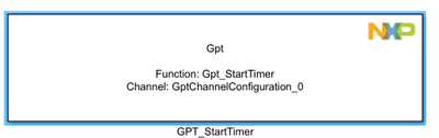

I am using S32k344 with MBDT.
I want Timer to use ticks value defined externally.
I want to give ticks value as input to the block using MATLAB's 'Data Memory Write' / 'Constant' or any other write blocks.
Any other block or methods is also appreciated.

Hi, @avinashstarkenn,
We acknowledge your request to integrate the functionality of configuring timer values from an external data store memory within the GPT block. We are pleased to inform you that this requested feature will be incorporated into our upcoming Model-Based Design Toolbox (MBDT) for S32K3xx release.
Victor

Hello @georgevictor
When will the new release be coming out.
How to integrate new release with existing MBDT for S32K3xx?
2,744 Views
georgevictor
The new Model-Based Design Toolbox (MBDT) for S32K3xx release is going to be launched in the second quarter of 2024.
In order to incorporate your ongoing projects into a future release, it is generally required to migrate the configuration projects associated with the Simulink models, either EBT or S32CT. Our toolbox features an integrated migration mechanism at the model opening designed to help users in this process.
