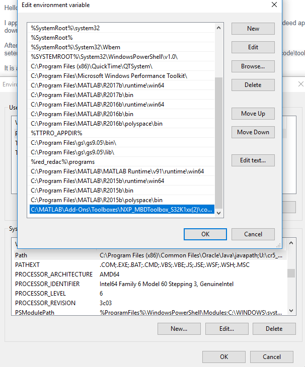

stefan130293
I run it on windows 10, I think they changed the env varibale interface. See screenshot.
Result of getenv('PATH'):
ans =
'C:\Program Files (x86)\Common Files\Oracle\Java\javapath;U:\cr5_data\cr5_resource\zeao\bin;U:\cr5_data\cr5_resource\bin;U:\cr5_data\cr5_resource\zds\bin;c:\Zuken\cr5000_R13\local\zsys\bin;c:\Zuken\cr5000_R13\bin;C:\Zuken\cr5000_R13\zpms\bin\Win32OODB;C:\WINDOWS\system32;C:\WINDOWS;C:\WINDOWS\System32\Wbem;C:\WINDOWS\System32\WindowsPowerShell\v1.0\;C:\Program Files (x86)\QuickTime\QTSystem\;C:\Program Files\Microsoft Windows Performance Toolkit\;C:\Program Files\MATLAB\R2017b\runtime\win64;C:\Program Files\MATLAB\R2017b\bin;C:\Program Files\MATLAB\R2016b\runtime\win64;C:\Program Files\MATLAB\R2016b\bin;C:\Program Files\MATLAB\R2016b\polyspace\bin;C:\Program Files (x86)\Seapine\TestTrack\;C:\Program Files\gs\gs9.05\bin\;C:\Program Files\gs\gs9.05\lib\;C:\Zuken\CR5000_R13\Lightning\programs;C:\Program Files\MATLAB\MATLAB Runtime\v91\runtime\win64;C:\Program Files\MATLAB\R2015b\runtime\win64;C:\Program Files\MATLAB\R2015b\bin;C:\Program Files\MATLAB\R2015b\polyspace\bin;C:\MATLAB\Add-Ons\Toolboxes\NXP_MBDToolbox_S32K1xx(2)\code\tools\gcc-6.3-arm32-eabi\bin;C:\Users\SBRU\AppData\Local\Microsoft\WindowsApps;C:\Users\SBRU\AppData\Local\Programs\Git\cmd'

constantinrazva
Hello stefan130293‌,
Indeed, in Windows 10 they changed how the environmental variables are displayed (made it more user-friendly in my opinion); getting back to the point -  the PATH variable seems to be good. I compared it with the one that I put in the call for setenv() [the one that works], and it matched it. I don't understand how it can not find it the first time, and only works if it's put from MATLAB directly. I'll try to force this issue on my computer to see what's the problem.
In the meanwhile, if you run that command when you start MATLAB, you'll manage to build the ELF file with no errors.
Kind regards,
Razvan.

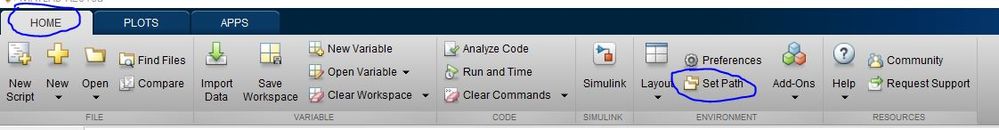

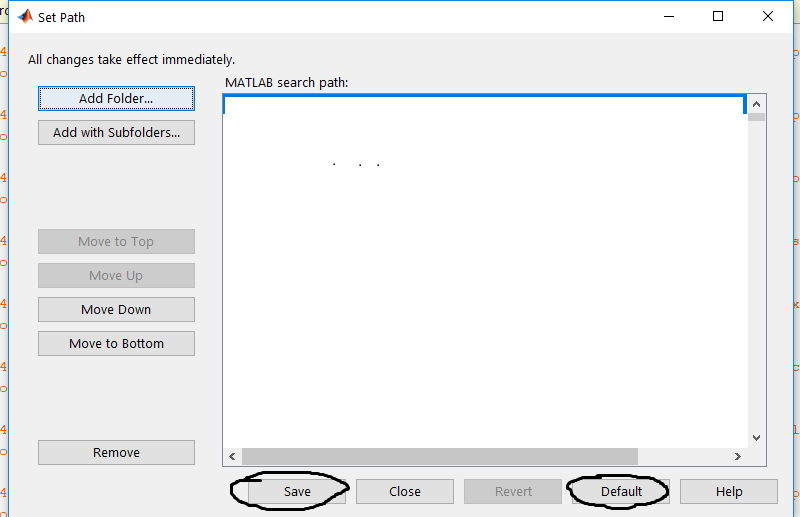

constantinrazva
I have not seen this issue before. Can you try and reset the MATLAB path? For that you should go to MATLAB Home tab -> Set Path -> Default -> Save.
and then run the mbd_s32k_path script again, so you install the path for the toolbox over a fresh, default MATLAB path.
Note: this will remove additional toolboxes path, so you'll have to add them back later.
And can you attach the project folder here, as a .zip? Just as the toolbox generates it, before copying by hand anything else.
