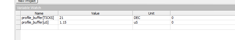

I've added a FreeMaster project and got the execution time about 21 ticks, which means 1.01 uS.
With a logic analyzer, we can see that the step function (when the led is toggled) is called every millisecond, as expected, because the step function, takes less than 1millisecond.

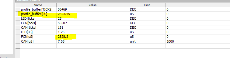

For this example, I did the exact same thing. I have divided the main model into 3 parts. LED, FUNCTION, and CAN with the mention that I have connected nothing to the CAN output pins, so the measured "transfer" subsystem is not accurate at all.
You can see that the Matlab functions code takes 2.8 milliseconds. The model time is 1 ms, so the PIT triggers the step, waits 2.8 milliseconds until the step function is completed, clears the PIT flags and after 3 ms from the step call another step function is executed. Same, 3ms are measured using the logic analyzer.

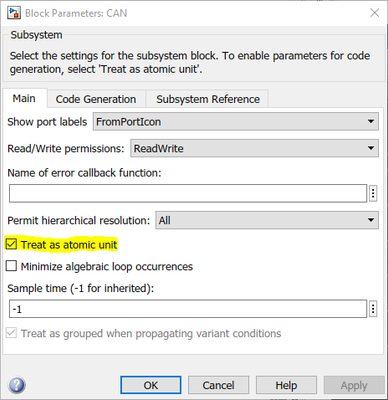

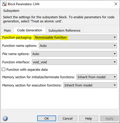

To make a subsystem eligible for the profiling block, once you create the subsystem that you want to measure, please right-click on it > Block Paramters > Check "Treat as atomic unit" and make it as "Nonreusable function". It also works with "Reusable function" too.

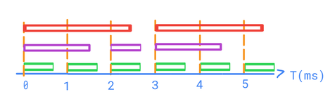

For the first question, if the step takes more time to execute than the sample time, the code will execute the entire step function.
Let me explain based on your scenario. If you set the sample time at 1ms, the model configures an LPIT timer to trigger an interrupt every 1ms. Every 1ms, an interrupt will trigger the step function to be executed. So ideally, the code in the main Simulink model should take less than 1ms to not lose any LPIT trigger. If the step time exceeds the sample time, the step function is not exited and continued to be executed. The next execution is scheduled to start with the next LPIT trigger if the step function is not executing.
In the above drawing ( you have to admit I am a little artist ) the blue line represents the axis in ms with the Lpit trigger. Every ms the Orange dottle line is the interrupt. The green represents the ideal case in which the Step function takes 0.75ms to be executed. As you can see, every ms you have the Simulink function executed.
The purple task represents a strange execution. The first time it takes 1.5 ms to be executed. So the next trigger is at 2. But then the Step takes only 0.75, the next execution is started at 3.
Your case is closer to the red execution (in my drawing takes about 2.5 ms, but for 4 ms is the same). So the next execution starts when the next LPIT trigger appears.

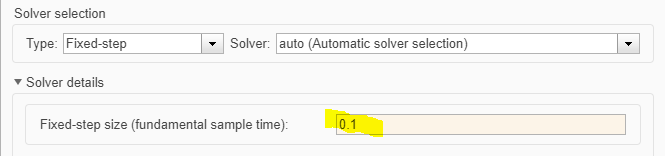

If you refer to the Fixed-step size, which in my case is set to 0.1 and not auto, this represents the execution frequency of the main model. Most of the blocks that appear in the main model (except the Config blocks and Interrupt blocks) generates the C code in a function called step_function. This function is called from an interrupt every Fixed step size value you type in the model settings. More details here https://community.nxp.com/t5/NXP-Model-Based-Design-Tools/MBDT-blocks-for-measuring-Idle-Time-or-Pro...
But be aware of the fact that your model, can take a longer execution time than the one typed in the input box which may cause a strange execution on the target. For this, you have to profile the code and see how much time the code execution takes. Maybe some optimization is required.
