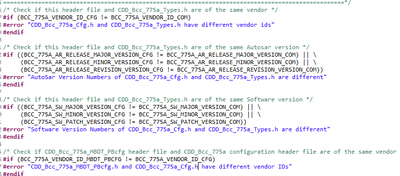

I have been trying to import the hvbmu2_775a_read_s32ct example of MBDT to S32ds platform and when doing so it appears this error:
Does anyone know what am I suppose to do or change in my platform?
Thank you very much in advance
1,189 Views
Irina_Costachescu
Hi @mgomez,
I have attached here a link to a community thread which addresses in detail the topic of MBDT applications export and import into S32DS. Even if a previous MBDT version is presented in the thread, the step by step process that should be followed for achieving your use case is similar. Let us know if you encounter any problems.
