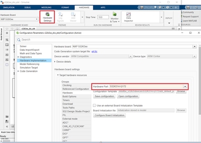

does the MBDT support the S32K314-Q257 processor? it isn't on the list. is it possible to use the S32K344-Q257 configuration for the S32K314-Q257 processor? if not, are there plans to add this processor? is there another work around?

For using the S32K314-Q257 processor, first of all you would need to select the S32K314 option inside the Hardware Part dropdown of the model's configuration parameters, as illustrated below. Even if this selection refers to a different processor package (172 pins), this selection will ensure that during the Simulink model build process, S32K314 specific files will be used.
Indeed, we do not provide a configuration project for the S32K314-Q257 package, so you would need to create your own, based on the hardware that you are using. Pins, peripherals and clocks must be configured according to your setup and the particularities of the application that you would like to develop. Hence, you could start from the S32K344-Q257 default project by changing the processor to match your selection, if the settings in that project are similar to your needs. For a description on how this can be achieved, in either S32 Configuration Tools, or EB Tresos, please check the following thread.
After you create a configuration project for your processor, with the necessary settings, you could use it as a Configuration Template for the models you will develop. For more details on this Configuration Template functionality, could you please check this link providing brief details on how this can be achieved and a reference to the MBDT documentation?
